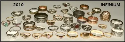

If you run the Infinium at the threshold set at 5-6, expect another 2-4 inches in depth. :icon_sunny:
WOW! i will give it a run
