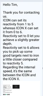

So I emailed XP last night to ask them if there are any advantages of the icon x over the icon with recovery speed and depth.
I have screen shot my questions and also their reply.
In case you are thinking of getting one over the other this may help your choice.
Also TN Sharpeshooter posted a video response for me on the mono frequency choices the icon x has paired with the FMF 9 inch Deus 2 coil
The icon has 4.4khz, 17.6khz and 32khz with their offsets of course depending on which channel it lands on during the frequency scan or which channel low to highest you manually choose.
The icon x has 1 additional mono frequency and that is 40khz.
This in itself made me wonder if 40khz is would be much more of an advantage over 32khz for me where I live. However after thinking on it for a bit I do not really see a big enough difference that would have for a coin shooter and relic hunter like I am with my mild soil conditions.
But......... the 2 additional settings of the recovery speed has gotten me to thinking a little more about the icon x.
