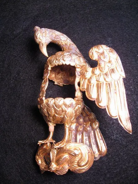

Well my thoughts are:
Found in August 2010, value $885,000.
enough said :icon_thumleft:

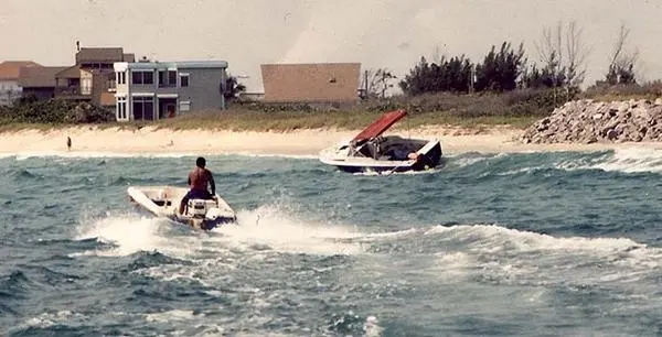

LSMorgan picture this: You have managed to work your way inshore through the outer reefs and are now anchored in 4-6 feet of water. That is the surf zone. Even on calm days (rare), you still have waves breaking where your vessel is. Once you lower the blowers, you have maybe 2-3 feet of clearance. You run the chance of bottoming out the blowers or your running gear or ended up on the beach yourself as a shipwreck. You are so close to shore, you have to run your stern anchors up onto the beach. We used to use old tires and bury them on the beach using shovels. Of course by the end of the day we were "too tired" to dig the tires back up. You can't get away with that anymore. Once you finally manage to get a hole blown, you have to time it perfectly getting a diver over the berm and into and out of the hole. A wave comes in or the seas get choppy and now you have the boat bouncing up and down and someone could get crushed. Then there is the noise from working so close to shore. The homeowners and condo owners and beach goers aren't particularly fond of the noise.
As Terry mentioned, Danny Porter and Clay Courdary had some success on the Cabin wreck using a catamaran as a work platform. Weller used a jetboat inshore successfully once or twice until he swamped it.
It might be feasible to work from the beach using some type of dredge...if one could get permission.
There is still quite a bit of treasure left from the 1715 fleet. Think shallow and think deep and get away from the same areas that have been worked for 50 years.
Attached is a picture of Mo chasing down the Virgalona II (baby Virg) when she broke her bow anchor working close to shore off the McLarty.

Tom, very true post. This is my favorite pic of "what can happen in a heartbeat". I remember that day well.

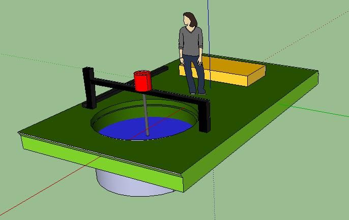

I didn't bother drawing in the floats since the idea of a floating work deck isn't exactly novel and obviously, nothing is drawn to accurate scale... Just wanted to see if the concept was viable?
If you made a small, pontooned work deck, , arranged a battery bank towards the rear to power an overhead frame mounted (and decent sized) electric motor towards the front which turned a light turbine blade on an extended shaft that was immersed in the water, housed within a series of adjustable, progressive nesting cylinders that could be adjusted to optimal depth, couldn't this work?
It would be pretty stable and if smartly designed, light enough to maneuver with a push pole. If you wanted to get real clever, you could probably make the whole system light and modular enough to disassemble/reassemble into man portable components.
It could be anchored at four points. With the electric motor, it wouldn't be nearly as loud as a gas powered engine- damn near silent. One could use all standardized components to make it. If they make electric motors strong enough to move a EV converted Volkswagen @ 50 mph, they'll definitely be strong enough to generate some pretty significant force on a turbine blade. The only machining that would need to be done would probably be the shaft, some couplings and some gears, then just some basic math to figure out weight/buoyancy/displacement issues and whatever minor engineering math had to be done to account for operating forces. You'd have to waterproof some stuff, too. Intuitively, given what the components would probably cost, it probably wouldn't even be that expensive to make something like this.
Since the propulsion arrangement is directly overhead and unobstructed as opposed to deflected, you'd probably need much less aggregate energy to move the same amount of overburden that a prop wash would move- especially considering you'd be in really shallow water and imparting the force very close to the bottom anyway.
One couldn't take it out on a day with 6' groundswells and obviously, the rough sketch doesn't convey what would go into making the rig stable in a surf zone but on a relatively calm day, it would probably be more than stable enough to blow away some overburden.
:dontknow:
That is what was initially tried in the early days of Real Eight. They had a barge type boat, and a big prop, no tube, sticking straight down through a hole in the deck. Then they invented the mailbox, first called ash cans, because they looked like metal garbage cans. The thing was made to blow surface water which is usually clearer, especially during a rising tide, down to clear it all up below. But the good side effect was it blew the sand away. Bad things were it was hard to move, and when it blew, it caused a suction vortex on the surface. That is why the blower was made, doesnt have these problems, but hard to use in shallow water. Yes, something like this could work, but not the way you have it. First of all, you cant have the tube all the way to the surface. It would need a supply of water. And electric could be used, but it would really use up juice fast on batteries. Maybe a small enclosed marine type generator would work with a big enough motor.
Maybe where the tube attaches towards the deck, there could be large ports for water to flow through to then be blown to the bottom?
It would be interesting to figure out what kind of balls are required in terms of how big the motor would have to be in order to blow meaningfully large holes. Obviously, something like this wouldn't be a replacement for the big stuff, but maybe an intermediate tool to do accomplish something more substantive than blowing with a DPV, yet still small and nimble enough to operate in the surf zone where the bigger boats have trouble.
You're definitely right that those big EV motors chow the shit out of battery charges... I guess that's why we still have gas stations :D

Kudos on the model!
