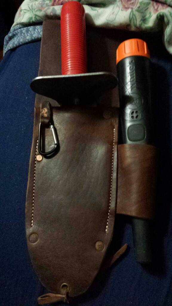

You mean this one? This is the one I bought from his ebay listing and it works great. Search ebay for "buzz bomb sheath", for anyone who is interested. This'll probably be the only sheath I'll ever need, due to the quality.
