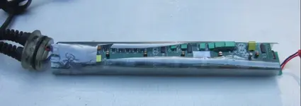

This is what I did to my Blue I had a spot next to my knobs that if you touched it would false.
I raped it in static bag I cut up and the falseing stopped to the touch.
It runs smooth but who knows when it is working or there is no interference out there.

Great Idea Jim!!
I know Mike and I had talked about redoing a complete new Pod that would be shielded on the inside with no knobs other then a charge port and toggle, on/off. Never got around to it but I really like your idea!!
OBN, I know Whites uses a spray in nickel shielding in their coils. It can be bought in an electronics store or I am sure found on line. I have used it in the past to prevent cross talk and alien cross talk, in building up detectors and fish finders, etc. works fine. Maybe painting the inside of the battery box and controls box might help.
