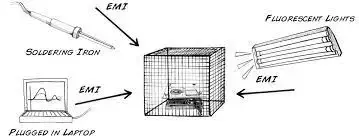

What about a Faraday Cage? Of course that may to much and hard drive to get to that point.
A true faraday cage would require covering 100% of the control housing, so what I have suggested is installing a shield over everything but the front control panel. Any EMI leaking out the back or sides should be absorbed/reflected/redirected away from the coil by the aluminum foil.
If any of you entrepreneurs are reading this, there is a large market for a control housing cover that has full EMI/RFI shielding built into it, including a shielded, clear plastic cover over the control panel on front. I've done the research, and the product does not yet exist (as far as I know), and I'd be happy to consult on both the design and marketing.
Absolutely!
I don't believe you have an EMI issue from any external source, however it is remotely possible that there is an intermittent EMI source radiating from the control housing and the coil is picking it up.
If that were the case, there would be a measurable signal emanating from the control housing. In order to test for this, a wide-band probe (it's a multi-frequency detector) and a spectrum analyzer or EMI receiver would be required.
Before going to that amount of effort and expense, I would disconnect the coil from the control housing and carefully check if any of the pins show corrosion. If there is none, then I would proceed with trying an alternative coil.
Also, while this next suggestion might sound a bit odd, it's worth a try.
Cut a piece of aluminum foil about twice the size of the control housing, including an extra inch or so on each side.
Fold it in half, and wrap/form the foil around the control housing top, sides, bottom and back. Use black electrical tape and wrap all metal parts of the coil connector on the back, and then form the foil around the cable/connector. Do not allow the foil to have direct contact with bare metal on the coil connector in back.
Charge it up and take it out in the field for a day and see how it performs. Let me know if there are any changes to the chattering, or if it shows up at all.
