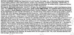

Alright, so I paid the five bucks to get access to claim locales just to see, this is what I got in return:
No fancy map or coordinates, just a paragraph of the markers (could be a post or tree stump) in some sort of quadrangle, with a shape (rectangle, parallelogram, square) and roughly how big it is. Ugh.
I guess I am starting to feel frustrated. I suppose I need to stumble around the forest and find old tree stumps and posts with a half ripped off sheet of paper telling me its claimed. I can figure out the quadrangle (I think that's what its called) on the cadastral (which I use to locate the public land) but the rest, I dunno.
I did find some closed claims, however.
If I can locate the discovery point of the claim, I can use measuring tools to figure out the boundary.

Another question: Is the point of discovery always the southwest corner? If so, I can get the Section Township Range from the BLM report
You need to look back farther at the recorder. That is simply the quit claim deed from when he bought the claim. You need to go back to the notice of location of mining claim to see the maps drawn by the person who filed the claim in the first place.
But all of the coordinates are there, so you can easily draw your own map of the claim. But it is a current valid claim that belongs to someone else. Time to put your boots on 8-)
