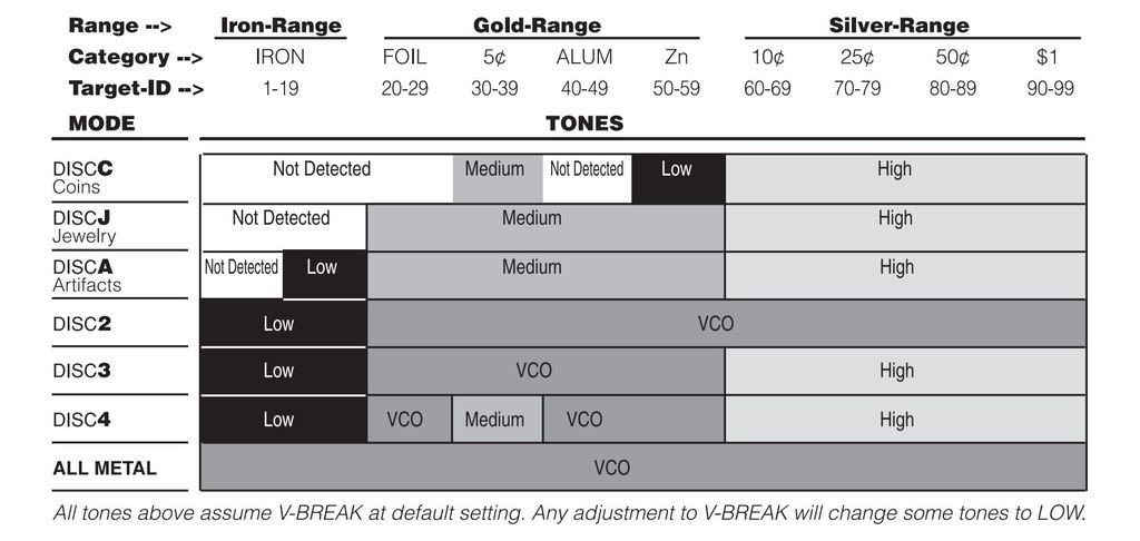

How many different tones does the LRP have? Maybe different in various Modes?:dontknow:

It has 4 tones...Low/Med/High and then VCO. They do vary in each mode. In Disc 4 you can use all 4 tones. It also has a V-Break option to change where the low tone comes in.

Ok the tones as stated before on Disc 4 (which I always run, disc=19 v-break=29) Low/Medium/High with VCO in the middle.
from the LRP manual...
"4-Tone Audio Target-ID
The detector will produce 1 of 4 sounds for any metal detected: V.C.O., low-tone,
medium-tone or high-tone. This audio feedback system is useful in conjunction
with the visual Target-ID system described above."​

Is the voltage controlled oscillator (VCO) only for the Iron?

Check out the graph on page 12.
LRP Manual
V-Break adjusts where the low tone stops. An extremely valuable feature.
On my favorite settings on DISC 4 with the disc at 19 and the v-break at 29, IRON is silent - LOW tone is 20-29 (foil range) - MEDIUM tone is 30-39 (nickel range) - VCO is 40-59 (aluminum and zinc ranges) - HIGH tone is 60 - 99 (coins and silver ranges).

One more Question. I know the LRP is not a Relic Detector but Where does LEAD show up on the # Range and what mode would one use? I want to use it not only for coins and jewelry but to detect all different sizes of lead. I know a spot where there is a bunch of lead in differing sizes.

I dug two old 44-40 bullets (1873 Winchester Lever action) they were cast lead with out jacketing or gas checks. I want to say they were around 48-50ish using disc 4.

They were just below the zinc pennies if I remember correctly. I will have to plant a couple in the test bed I am working on.
