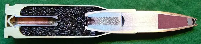

#1. The Spotter Round Cartridges are actually made up by us and never existed in factory produced
ammunition. The projectiles were pulled from the M48 Spotter Cartridge used to assist in
targeting of the larger 106MM & 105MM Recoilless and Howitzer Artillery weapons. This
projectile Traces-Smokes-and Explodes on impact creating a large flash, then it lays there and
burns. This is the most dangerous projectile of the eight examples shown here as it has encased
in its nose a sensitive primer. This cartridge can be detonated by simply dropping it on a hard
surface like concrete. The odds of finding one of these laying around would be very slim, but
possible. I will include a cut-away picture of this projectile at the bottom of this post.

"NOW THIS EXAMPLE IS A BADBOY".....this one you don't drop, don't ask me how I know. ;D
