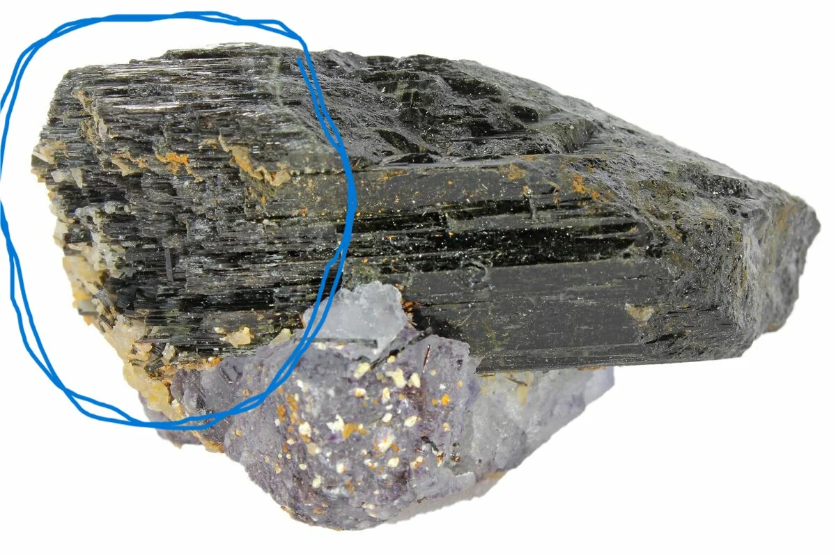

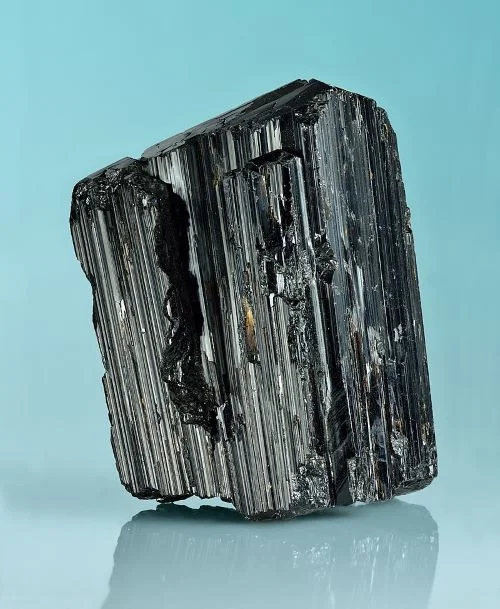

Well i discovered proof in the small rocks that they are not bog iron. After studying all the crystals inside the rocks i noiticed that some of them where broken and reveiled striations like a tourmaline crystals, see first photo. And tourmaline like crystals can not form in bog iron because that is a whole diffent formation process. I checked the AI on google. The second photo shows what the broke crystals look like as an example

Well, I can only comment on what you show me and (reliably) tell me. Neither of those pictures are from your specimen though, are they?
You initially described the crystals as black, then as translucent brown, now you say they're striated. As already said, translucent brown siderite can occur in bog iron and crystallizes in the trigonal crystal system; crystals are rhombohedral in shape, typically with curved and striated faces.

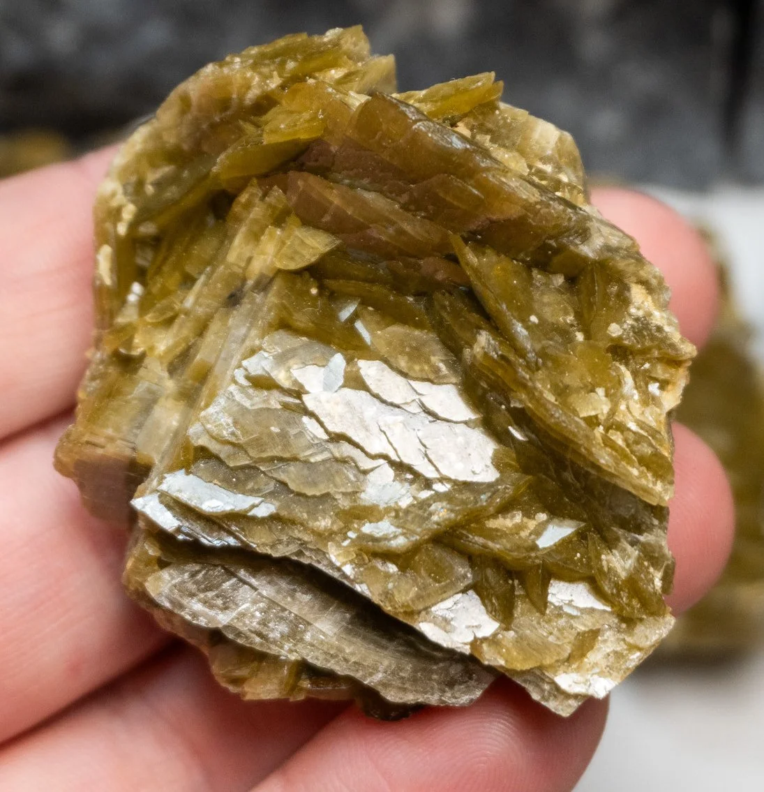

This is a typical habit for siderite, although small crystals as an accessory mineral won't have the same appearance:

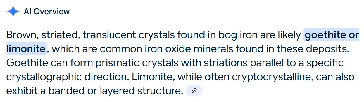

If you're using AI to assist in identification, then a simple query: "brown striated translucent crystals in bog iron" would have yielded this:

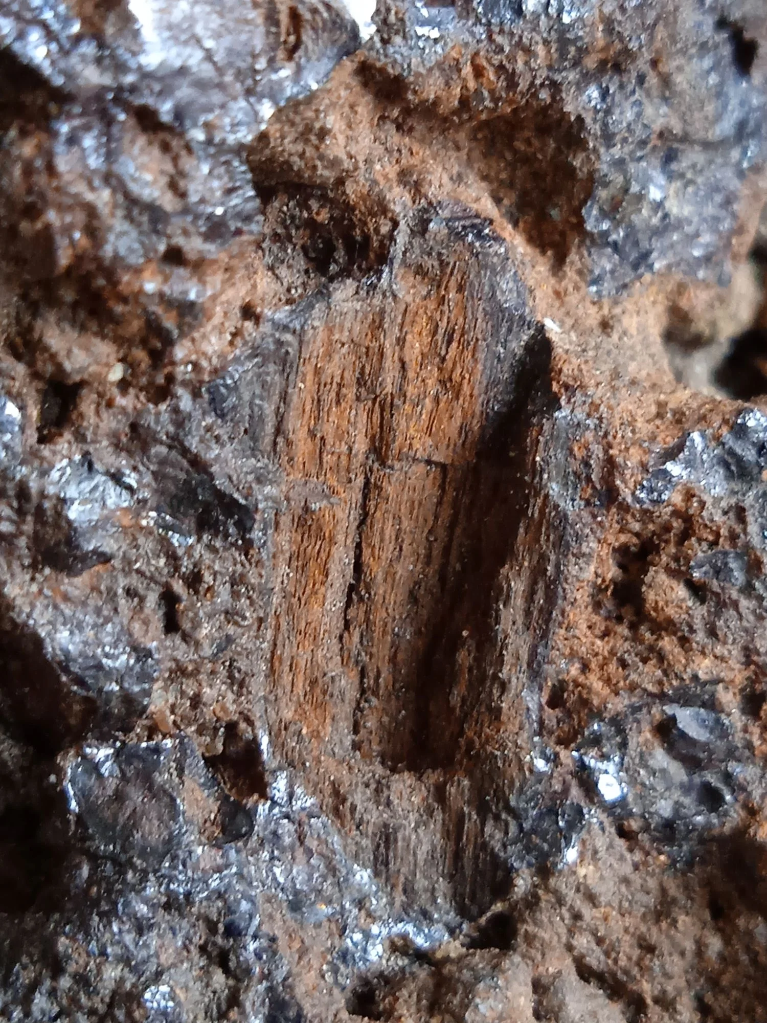

here is a closeup.

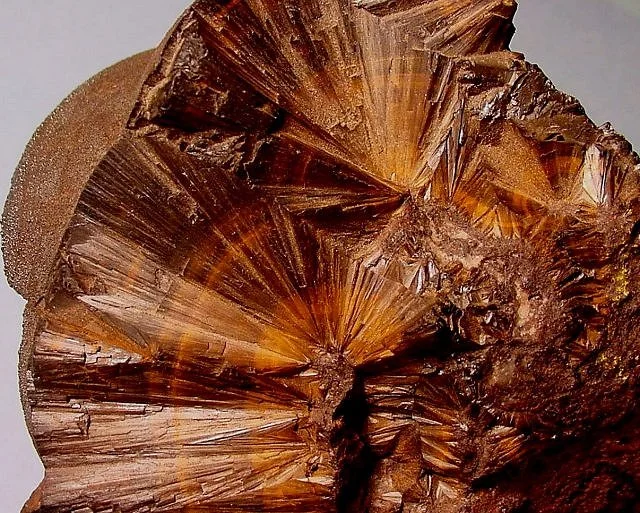

... which is visually consistent with goethite/limonite possibilities in bog iron. This is one of the habits for goethite [picture from R.Weller/Cochise College] but your is obviously heavily weathered:
