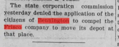

The word Frisco probably refers to the Frisco Rail Line that ran throughout the Midwest. It was both a passenger and freight line. Their home office was in Oklahoma City ...

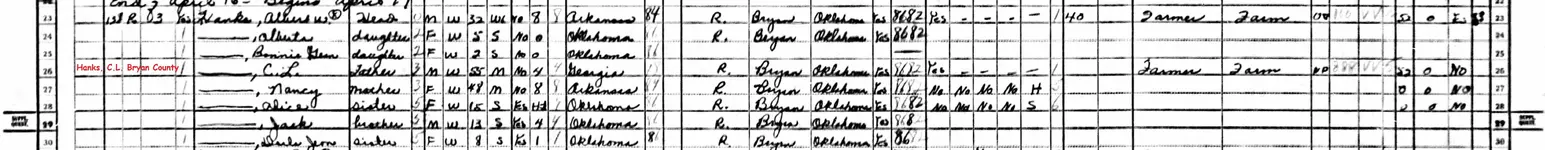

I did find this 1940 U.S. Census for C.L. Hanks of Oklahoma. If you save and zoom it you will see where the entire family lived in Bryan County Oklahoma in 1935. Bennington is in Bryan County. It shows C.L. Hanks as a farmer with his son, who was the head of household at the time. C.L. was 55 years old. It appears to me that the Hanks family moved from Bennington to Farris Township sometime between 1935 and 1940. I'll see what I can find for the 1920 and 1930 Census. That is if someone else doesn't do it before I do.

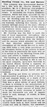

Just a little bit more about the Harding Cream Company from 1906 - Incorporated in 1904
