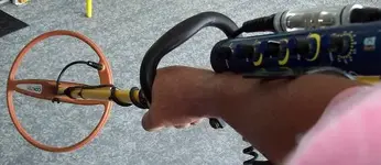

Here’s my new custom built beach sweeper.
1) Super strong, stiff, lightweight fiberglass shaft for maximum control and zero deflection.
2) Slotted forearm cuffs so they can be custom fitted to the forearm. (Always nice and snug like they should be.)
3) A power handle that can be rotated 360 degrees and slid up and down the shaft so I can attain custom comfort. Also can be arranged for two hand control when battling stiff currents.
4) The Excal control box is mounted at the side so the controls are always visible and within easy reach.
5) And finally, a WOT coil so I can attain maximum depth while covering more ground with each sweep.
The balance is great and I can swing this thing all day long. The tighter cuff fit, power handle, and stiffer shaft has made it a lot easier to hunt the surf. Now I just have to find a way to get to the beach more often. :icon_scratch:

I dont see what a slotted armcuff is, I use a velcro strap on mine which keeps it real tight. You could put a velcro strap on yours for more tighter fit. How did you bolt the housing to the pole? You didnt bolt through the housing did you? Nice set up. I have done some diving set ups with PVC that was filled with fiberglass strands and resin making it heavy(for heavier than water underwater work) and stiff and unbreakable. I used a T fitting for the handle and ran the fiberglass down the handle and went both ways with the strands, and poured in resin. Real stiff.

I'm a small guy with small forearms. The arm cuffs on this unit are two pieces and they are double slotted so I can bring them in to fit snug around my forearm, otherwise, even with a velcro strap my forearm was sliding from side to side. I bolted the control panel to the shaft by running two long stainless screws through the shaft, then through two fiberglass tube spacers with a radious cut in them where they meet the shaft, then through the control housing mounting holes, then the wing nuts. The coil coupling is fiberglassed into the shaft and I used marine resin on the inside to further secure it. It will never work loose. (I used a small piece of fiberglass tubing inside the control housing mounting plates where the shaft usually goes so I wouldn't stress the housing when tightening the wing nuts.)
I see!!! Very cool. Good way to tighten it on your arm! And a good way to attach the housing to the pole too! Is that yellow fiberglass pole a painters extendable pole?
Exactly. It's a one inch pole. I found it at a garage sale, was one of the older industrial grade shafts. I gave .50 for it. :laughing7:

Very nice looking Excalibur, Lotta work went into her on all the modes. I like the way you can reach the controls, and the handle very different and functional. What headphones are those I don't recognize them? Good Luck and She should bring home the gold now with the big coil.......
The headphones (guts) are actually stock, but Mike did a little shopping around at Harbor Freight and he found some pieces that allowed him to sort of assemble a quieter setup. You can't even hear a stiff wind blowing once you have them on.
