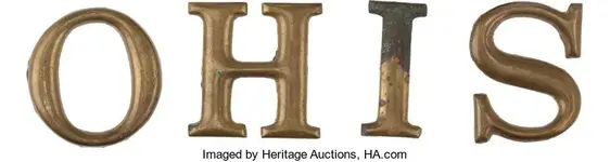

One never knows how reliable auction attributions might be, but these were described as:
Group of Four Early US Military Cap Letters. 1½" high of heavy stamped brass, lead filled. Brass wire prongs on the reverse for attachment. Exhibiting some oxidation else perfect condition. Probably C. 1835, but possibly earlier. Very scarce.
The typeface on yours is a lot thicker, but they're about the same size. I have no idea how much that may have varied, if indeed the attribution is correct.
