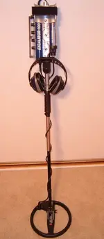

some people swear by the upper shaft mounted excal....................not me, but here is a pic of one, both scoop guys sell them

Thanks, So the aluminum one is lighter but the sand doesnt drain as fast? do you recommend it over the other one? is there any benefit of the the straight shaft over the stock one beesides the weight issue?

i did not address your straight shaft deal because i do not know anything about them. i do read where everyone loves them that use them....................we have at least two here at our beach that use them and about two that use the minelab original mounted on the shaft..................very heavy that way and until i try one mounted under the end like that, i am saying it has to be kinda heavy as well................B U T i do not know this and i WILL NOT EVER FIND OUT.
here many of us belt mount ours.......................doing this all the weight is on your belt in the back and u can hunt long periods of time without any problem......................B U T one must take care to protect the wires when mounted in this manner.

Thanks for all the info. looks like I have a difficult choice with the scoop. I would definitely like to hip mount the excal but i do worry about the wire I don't want to damage them. I guess will will try it the way it is and see if it gets annoyingly heavy before I decide on that.
