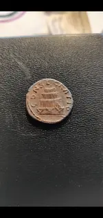

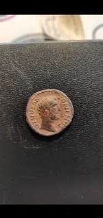

I can't clean it up any more, the museum wouldn't be happy with me if I do that. My friends coin is this one, maybe that will help.Screenshot_20180815-200815.webpScreenshot_20180815-200755.webp
I can't clean it up any more, the museum wouldn't be happy with me if I do that. My friends coin is this one, maybe that will help.View attachment 1622185View attachment 1622186
Divus Antoninus Pius Denarius. 161 AD. DIVVS ANTONINVS, bare head right, drapery on far shoulder / CONSECRATIO, four tiered funeral pyre surmounted by quadriga. RSC 164a. * Sear RCV 5193 * WildWinds.com
Thats any easy one to ID & is a very nice example. It might help as it does have a similar bust/head type to yours so its another research route.

I think the two of you came as close as possible, with a coin that is in such a shape. I now can see that the reverse is upside down, great job to both of you, and thank you very much for your help.:occasion14:
