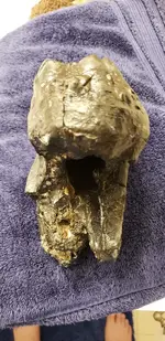

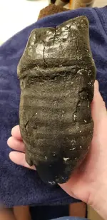

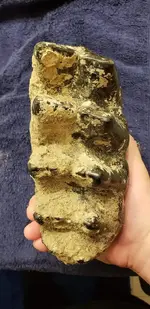

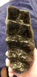

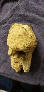

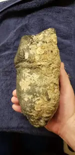

Ok, for the record, I did not find this tooth, it was found in the Savannah, GA area in the water. This is an adult tooth with little to no wear on the enamel and partial jawbone in the tooth roots.
Here are before and after shots keep in mind it took two weeks of soaking, and three cleanings to get to this.
Great addition and nice work prepping it! Can I ask what soaking/cleaning technique you used to prepare the tooth?
So cool! That guy musta brushed and flossed regularly! Thx for sharing, really neat stuff..Ddf.
I usually soak any fossil from salt water with shells and other stuff stuck on with a 50/50 mix of distilled water and vinegar.
What I cleaning process steps are is something like the following;
1. quick wash with a stiff cleaning brush to try and knock off most the dirt etc.
2. 4 hour soak in a 50/50 mix
3. pull out of mixture and I use plastic scrapes and picks (the ones I use are the same that are used for aircraft work since I have access to them)
4. back into the 50/50 mix for 4-8 hrs
5. repeat the picking/brushing and mix. in this case, I did the it three times.
6. now this last step was not done on this as all my tools are in storage until I buy another house but my final step would actually be an air scribe to do final cleaning of the stubborn pieces but this one came out pretty good.
