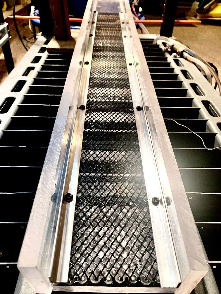

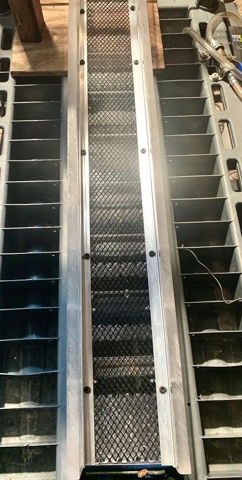

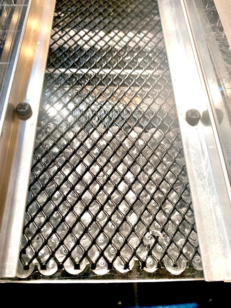

Each hole needs to actively replace the lighter material, if it just fills up the gold will not settle and flow right out.
you could make a little lip or put rows of 1/4" strips across between the holes to keep it moving.
expanded metal over each set might work, I've used metal paint roller bucket grid over carpet worked good in a pinch.
you could also make a swirl to imitate the goldwell sluice or dream mat,
you could build up a lip with super glue and baking soda, carve it with a dremel tool
or something of your own, lots of fun creating something.
I would think the 1/16 holes would be hard to keep clear and clog up BUT maybe the C.Sinking the holes would help keep them clear ??? your test run should tell !:thumbsup:

The mentioned concerns were on my radar as well... so instead of giving it a go I went ahead and addressed the potential issues.
I opened up 1/16" dimples to ~1/8" and can go bigger if necessary of course.
I also added some of the small "gutter-mesh" over the whole thing. I screwed down some small chunks of aluminum angle to keep the mesh tightly in place.
Here are a few pics of the changes....I'll give it a try tomorrow.

It sounds like you are using the sluice to clean up concentrates. What size material are you running? If it is all fines (30 mesh and finer) then deep v mat may work well for you. That is what some Washington beach miners use. Ocean beach sand is almost 100% minus 100 mesh as is the gold that is captured.
Good luck.
I had a gold well, sold it a few years ago, if I remember the holes had a spiral in them which created the vortex tat helped keep the gold, the maker used a CNC to make the sluice,(it was heavy solid Aluminum). I do not see a spiral in yours.
