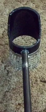

Well just finished building a scoop used a 4 inch pvc pipe with a 1/2 inch galvanized pipe (think it is over kill way heavy) and made a screen basket for it. Here are some pics. It ain't pretty but should work until I get enough funds for a bought one.

you might want to bevel the digging edge, to make it dig a little easier
Thank you and I did the bevel after your post and your right did dig better lol
you also might consider building one with smaller holes in the mesh to retrieve earrings and the like. JMO
What size might ya suggest?
I'm not really sure, because if it's too small, damp sand won't go through, maybe 1/8 inch or 3/16 inch
Will give screening a look see and see if it will work.
