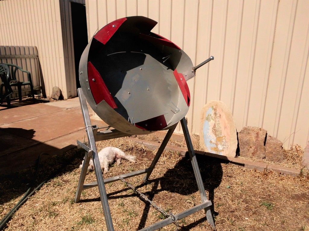

Last year this model evolved , simple to use hand cranked ' turn clockwise 8 times then reverse to empty the lights , reload more dirt & repeat again & again till ready to tip out the final heavies , could be a 100 buckets or just one , will still be the same amount left ~ just a third of a pan of heavies .
The little dog is having a day/dream :laughing7:

Jack, Now that is nice!
I see tines and such to break up the material when going clockwise. I think progressively lower catches to empty the lights when going counter - leaving the heavies right next to the bottom wall. I see how it can fold for transport and I can imagine the rotation axle on the rear. Looks very robust and easy to use. I would love to see a few more shots at different angles and any other written insight. Do you drywash the heavies or just pan it out?
Congratulations on a very creative approach

Thanks Thurman , That model is now redundant ' I wanted a unit that could retain very fine gold & up , needed to be able to process twice as much material twice as fast & be more portable .
2 weeks ago the break through happened :hello2: new design allowed the dry material to be liquefied therefore getting wet performance without the usual 10~15% loss of most dry systems .
Can now reduce 25Lbs of material to less then 1Lb in under a minute , think that's a about 97% .
Final clean up is always just a third of a 12" pan .

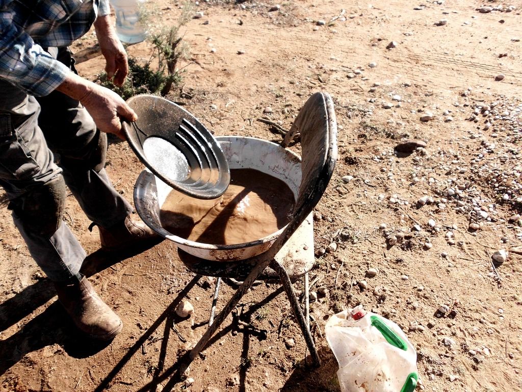

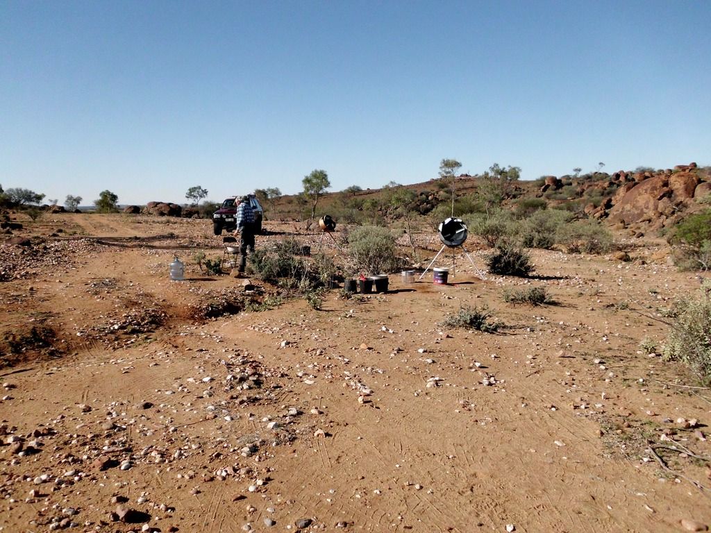

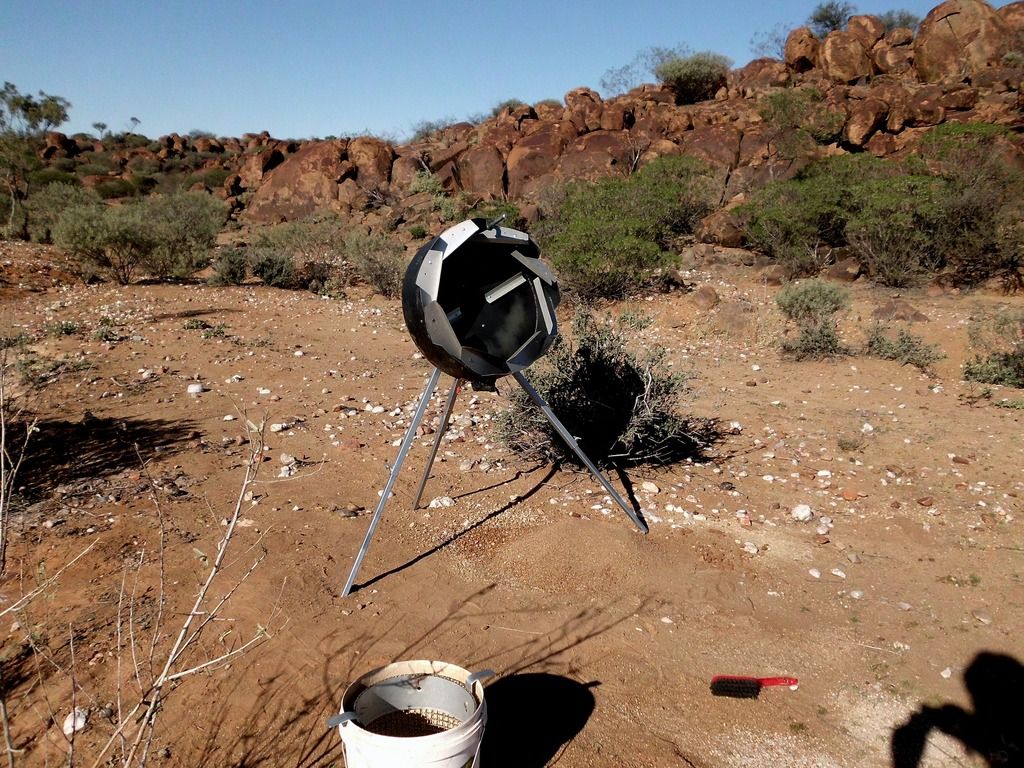

Here is a pic of past unit last year , this area had been hit hard over the past 30 years with detectors but was still loaded with fine fold :laughing7:
Not cool dude... Tease all the way to the final panning and no money shot?
