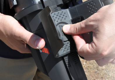

I received a new CTX a few days ago and I can provide a few pictures to show the difference:
Here is a picture of the new upper shaft and the back side of the new arm cuff. Being honest, it seems like there is more to go wrong with the push button feature, but I know the old style left a lot to be desired. I've had problems with the old style not locking and then coming loose while I detected. It almost seems that simpler is better in this area such as having a toggle that can be tightened and then hinged down, perhaps similar to a mountain bike wheel nut.
Other then the notches on the new upper shaft, everything looks the same, at least by eye.

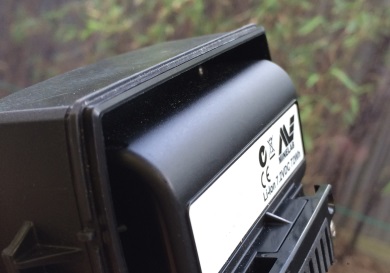

Concerning the battery, there isn't a extra seal or anything. It appears that there is a raised lip at the base where it fits in the groove over the "O" ring. It also appears that there is more of a lip to keep sand from infiltrating the O-ring cavity. I put the new battery on my old CTX and it fits and powers up just fine. It also appears that the old battery fits and charges on the new base. There is also small notches (shoulders I should say) on each side of the battery where it clicks in on each side of the hinge. The old style battery just sat in the groove and if you didn't secure the battery latches with a rubber band, it could easily fall out if it came unlatched. This never happened to me without a rubber band, but it could. The shoulders caused the battery to "lock in" with a little resistance whether you placed it on or took it out. I heard a definitive clicking sound. It appears that the new battery just mostly has a deeper lip to fit in the groove with more of a molded ring around the circumference to limit the sand from entering the battery compartment as well as a thicker O-ring. Essentially, it appears that it seals tighter in the groove.
The new battery is to the left and the old one on the right. Note the little "shoulders" on the new battery, where the hinge locks.
Lastly the new O-ring is a little bigger in diameter than the old style. I was going to measure, but I temporarily misplaced my dial caliper. Here is another pic:
New O-ring at the top and old style at the bottom of the picture.
