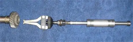

It must be a bearing or seal puller. Maybe a specialty tool from a now defunct auto maker. Here is a pic of a puller for a Ford tractor trans.
Not exactly the same but you get the idea...
Agreed. I think we've basically narrowed it down. Would be neat to know it's exact application though. You know. In case it's a muffler bearing puller on one of the Apollo Space missions..... :)
