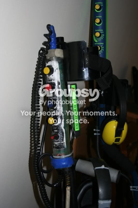

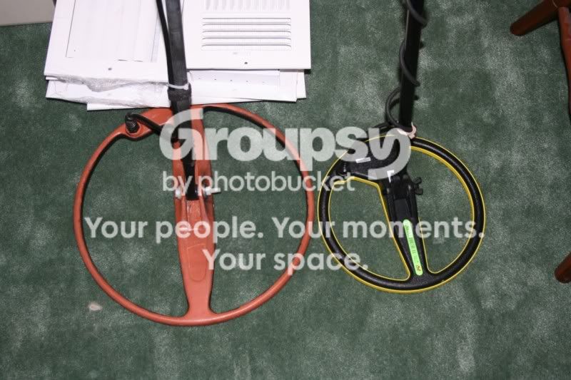

Picked up an older Excal with a 15" WOT on it! Didn't have a battery so I got a real good deal not knowing if it worked or not :)Its well worn but works great!!!!! I sprayed the bottom of the coil with a couple coats of bed liner paint. I did a few bench tests and HOLY COW!! Compared to the stock 10" Tornado on my new Excal 2 I can tell this baby is gonna get some serious depth!! Noticed the sensitivity has to be turned a bit further down but it doesn't seem to affect depth in the least. I have a question as to the age of the excal. The decals are very worn but the best identifier I can give you is that there are white lightning bolts on a black background on the tabs that mount to the shaft. The knobs have all been changed and it has been opened at least once so I am not going to submerge it, just use it for edge hunting. Can't wait to get out there!! Pics to come.....

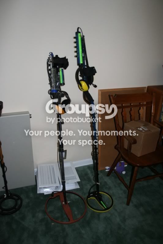

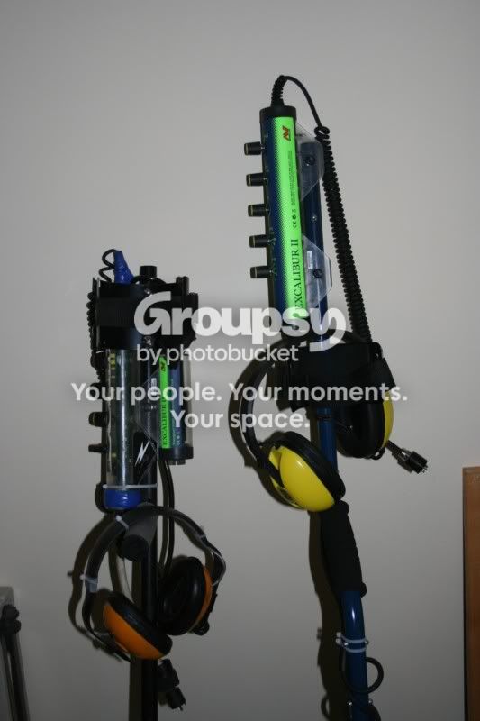

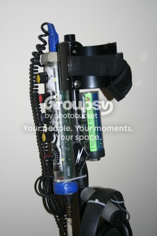

Pictures as promised:
I had to rig the shaft to suit my needs, it was set up as a hip mount or some weird design. I drilled it for the configuration you see here. It swings comfortably.

I have a blue sword, first type, and it has the black with white lightning bolts, square mounting tabs (yours are cut to fit the newer style battery pack) and the white around the knobs on a black background. I dont have a solid blue one to check against, but mine has been great. You should be able to see a handwritten #number inside the case, through the clear tube. I think from the bottom. That would also help. But I think it is the oldest model, which is good. Here is the best deal out there for good battery packs and chargers. http://www.onlybatterypacks.com/items.asp?db=48

I can see after studying your pics against mine, you have a blue sword. You can see the hilt/guard of the sword where it comes up by the threshhold knob. Those are good. But I dont think I would trust their waterproofing job. If you want it waterproofed, you should take the end caps off, by using an allen wrench, and very carefully prying/sliding out the ends. There are O rings on the end caps, replace them. Ace hardware should have them. lube them with silicone grease. Then when putting it back together, use silicone grease on inside of barrel, and on end cap. Do this quickly, and slide together, dont put it on heavily, just a thin, even coat. This should be done in an air conditioned room to keep it dry. Slide until back to where the allen screws go, and tighten them. Put a seal of silicone sealant on endcap to barrel joint and on allen screws. Do this on both ends.
Steve,
That is it alright! Thanks!! I cut the square mounting tabs at an angle to accomodate the battery. Yours looks in excellent cosmetic condition, mine is well worn. I think the guy who owned it used it a lot and he had it atatched to a sort of hip mount/chest mount. Also the blue tape is securing two loops at either end that he was using to clip this belt mount onto. It looks well sealed but I am not going to risk it. I have my new Excal 2(under warranty for 11 more months) for under water and I will use this for edge hunting and or as a spare or for my mom or dad to use. We are staying at the beach for a week right after the 4th of July so I will get some serious time in and my mom really wants to try as well! Thanks again and thanks for the link on the battery pods!!!! :thumbsup:
