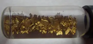

Here is a photo of about 1.5 grams collected yesterday on the South Fork American River… 0.9 grams came from a single shallow crack that I was CERTAIN had already been prospected by someone else (guess not)… the rest was fairly evenly distributed at 3-5 flakes (plus fly poop) per pan. You can bet I took a looong look at why the high-yield crack collected the gold it contained, and I will be looking for cracks morphologically and hydrodynamically similar in the future.

Nicely done!!
You've got some solid tips there. Thanks for sharing.
As well, you've got some pretty gold to boot.

Lotus G Great finds.... I was up on the SF too same day and I see you found that crack I left for you LOL... Was that you prospecting from the kayak? Keep up the finding....

Way to go Lotus... Like you I like to travel very light and be free to move about. Nice find on that crevice... I know that smile that comes across your face when you roll back the black sand in the bottom of your pan and see the big flakes start to show... :thumbsup:
