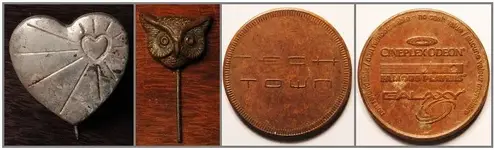

Headed out for a couple of hours after work. Pulled in lots of coins. The ACE 400 precesses the audio much different then the Garrett AT Series. The AT Series present a modulated audio out of the speaker, meaning, the shallow and smaller targets are louder then the deep ones. On the ACE 400, the deeper and smaller targets get an audio boost, making the deep targets easily audible. There are benifits for both types of audio.
Below are the bling and tokens......

Congrats on the finds with the new Ace 400 & wishing you many more while out dirt fishing. Thanks for sharing the pictures & post with all of us.
