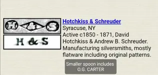

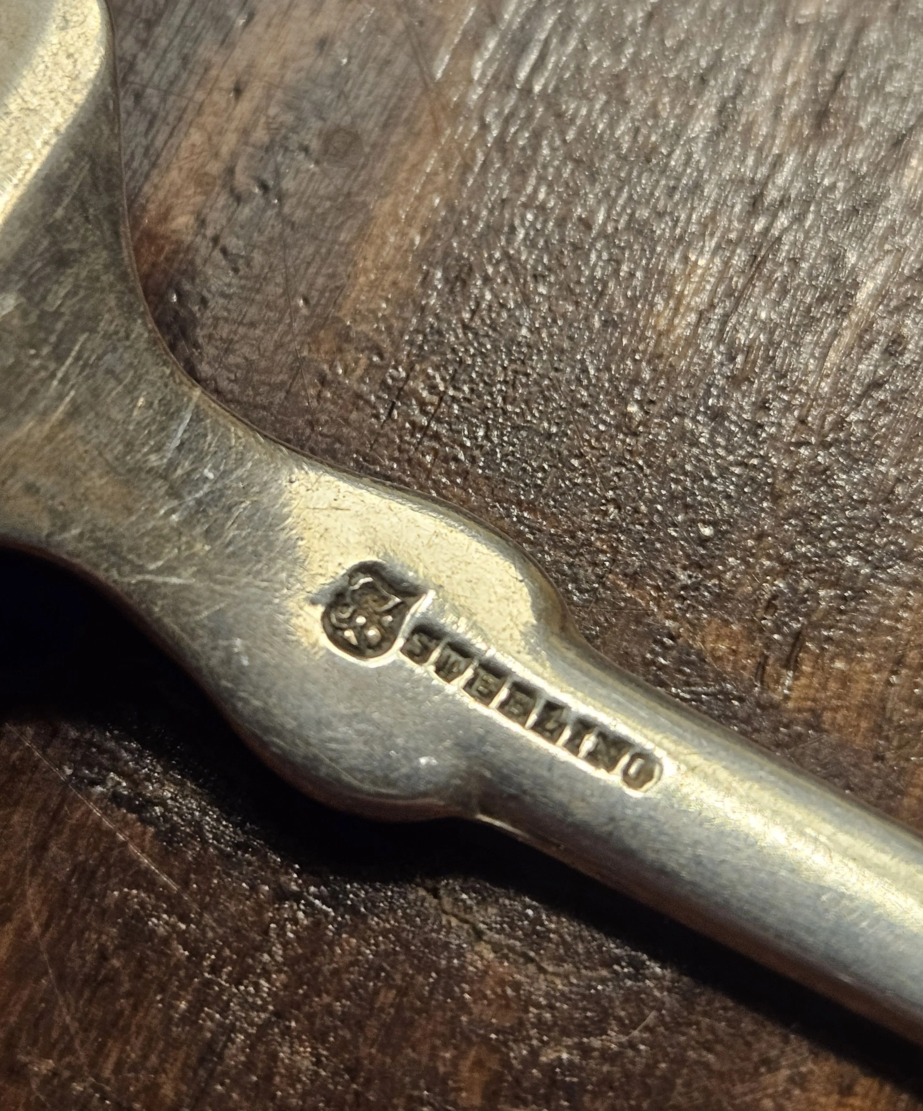

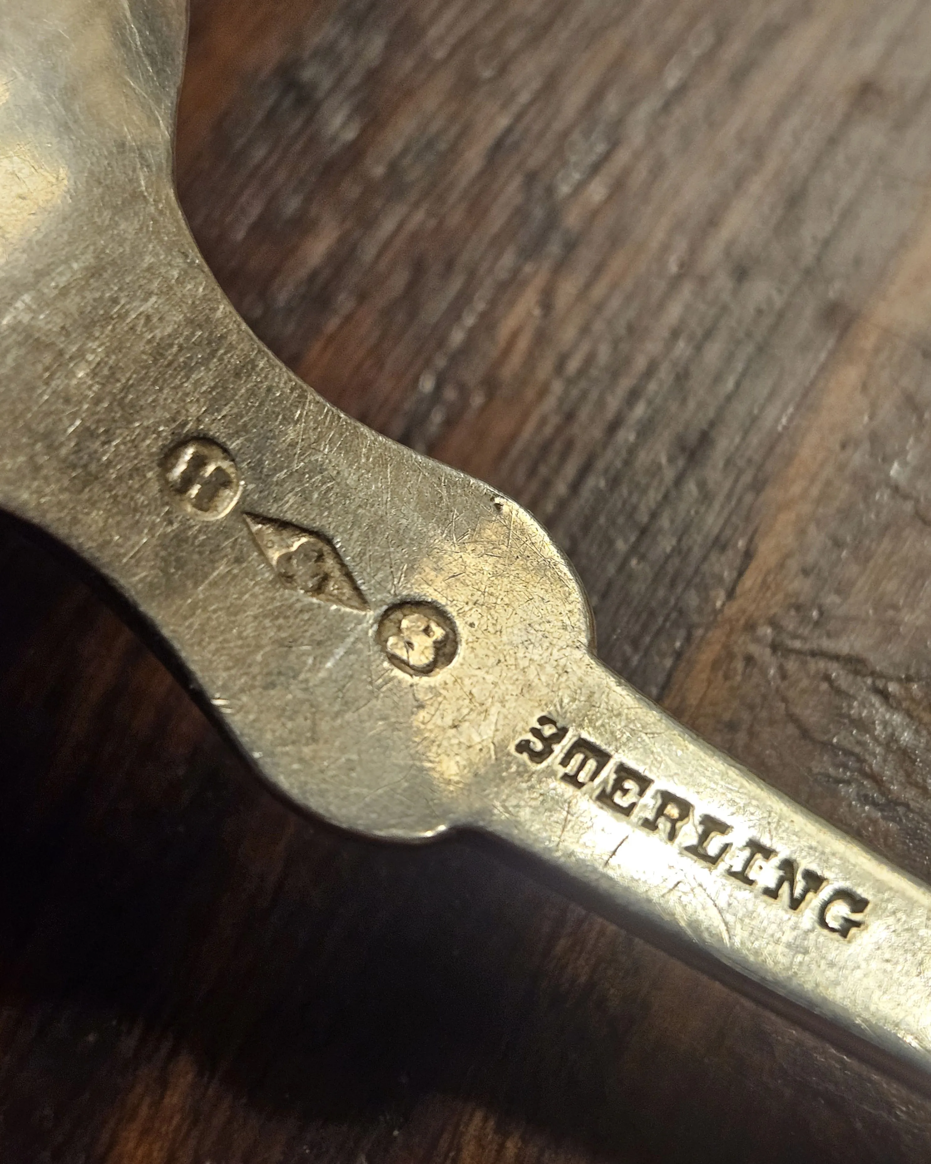

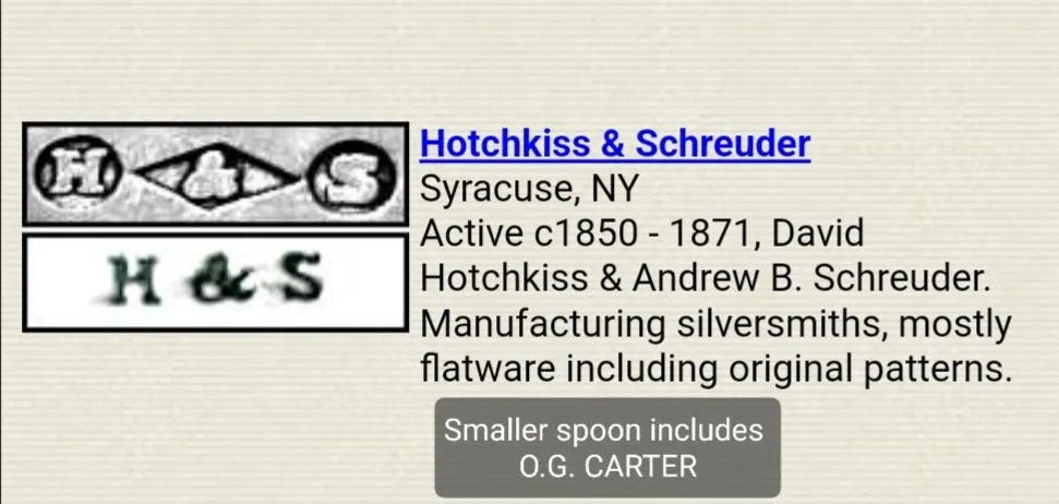

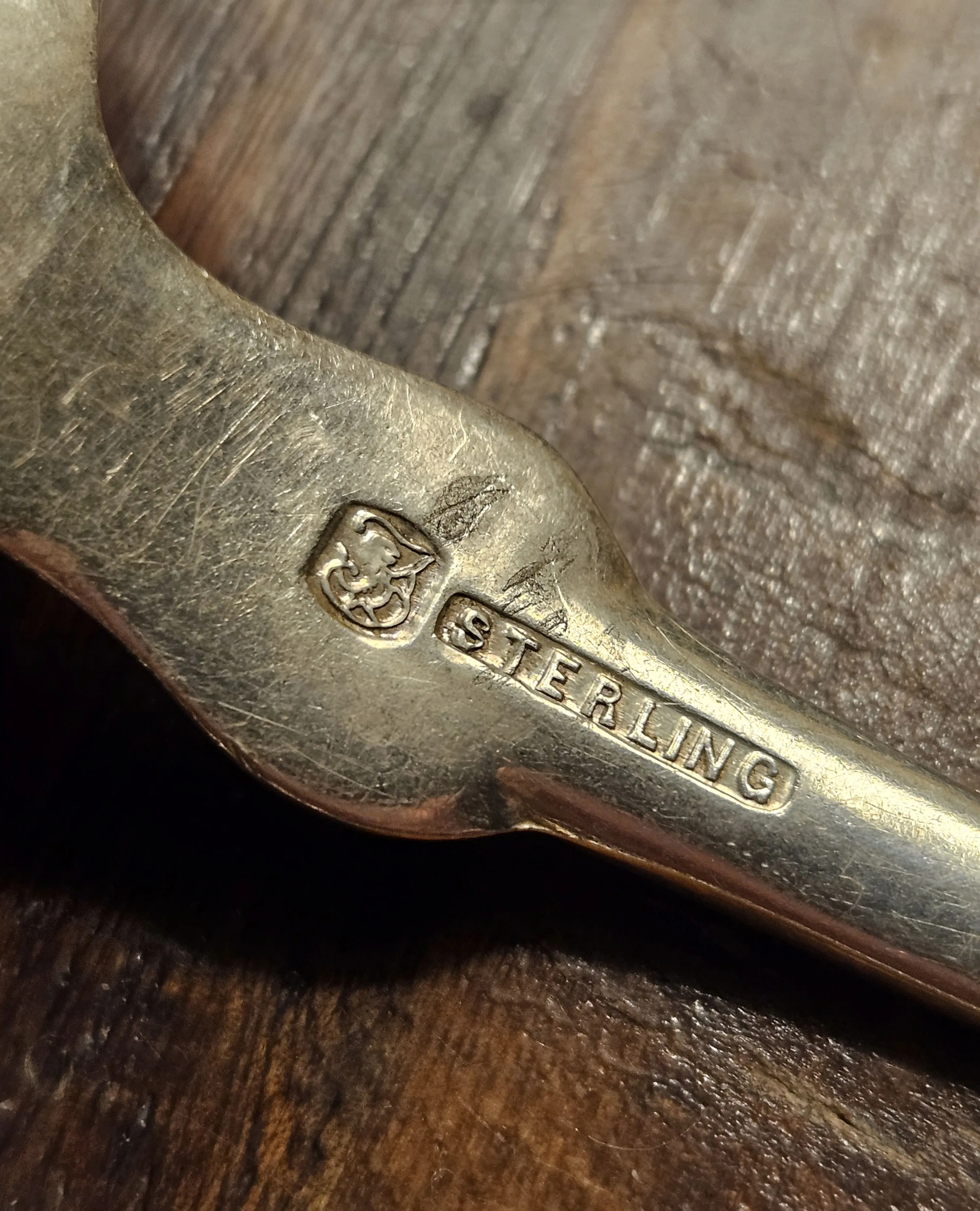

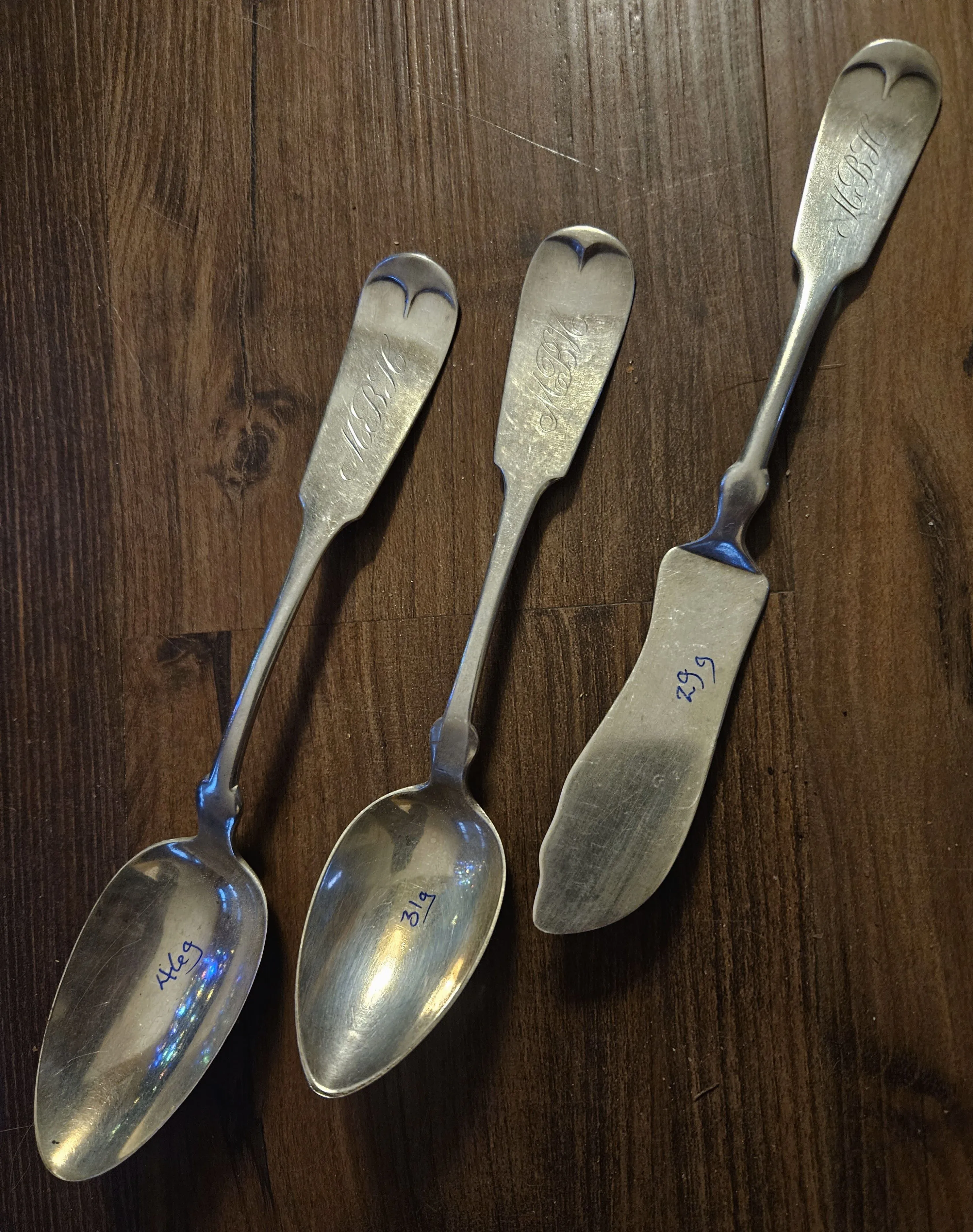

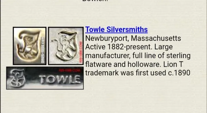

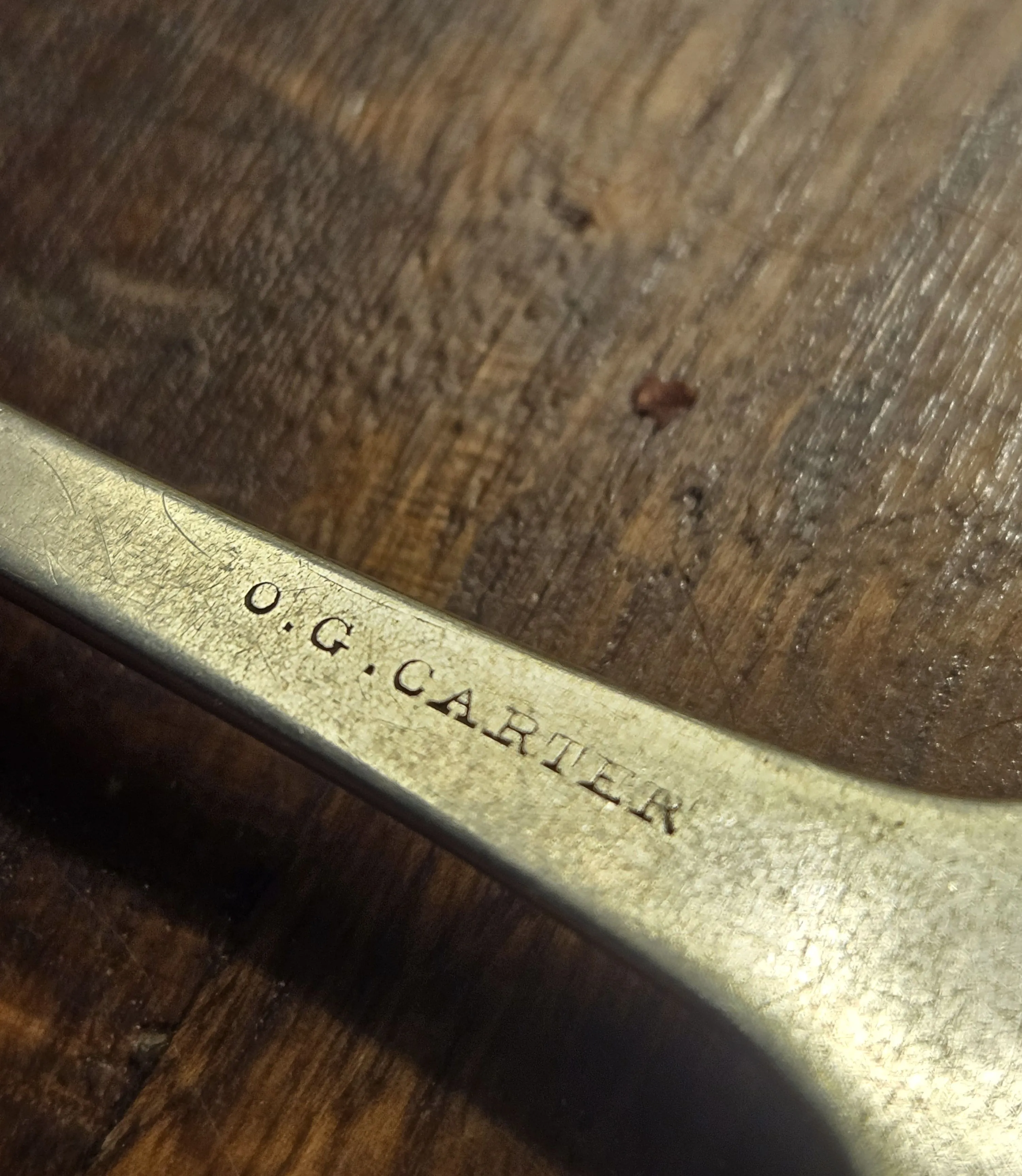

Stopped by the church thrift shop today. Most the time in the tray of flatware they have at times some silver-plate, and much more stainless steel these day. I saw these three, all marked sterling. They clearly came out of the same service, because the monogram of MBH is on all 3 pieces. The larger spoon and knife have a pictorial mark of Towle Silversmiths and from what I gather are maybe made as much as 30 years later than the smaller spoon which has the mark of Hotchkiss & Schreuder, that from what I find was no longer being made after 1871. There also on this small spoon a mark of O.G.CARTER, which might be a retailer it was originally sold? It has a flat center stem over a more oval and stronger stem of the two pieces of Towle made pieces. I'm thinking this set had belonged to a family for a few decades and newer pieces were added as maybe some of the guests they had invited pocketed a few pieces over time. That's just a thought. 🤔

One of the advantages of buying flatware with a long-lived pattern is that you can easily add matching pieces if you need to replace lost or damaged pieces or want to expand the set. That's a more likely explanation than guests pilfering pieces, I feel. There is indeed a gap in dating between the pieces, but maybe not quite as large as suggested.
Almost every reference source says that Towle “adopted” the script letter T enclosing a lion rampant trademark c.1890, but that isn’t what the trademark registration application says. Towle didn’t actually register the mark until 1905 and the application says that “first use in commerce” was 1883. That is, they were using the mark unregistered from that time, although not necessarily widely so. Anthony Francis Towle established the Towle Manufacturing Company in 1882 while still owning A.F. Towle & Son. The “tipped” pattern for your flatware was introduced in 1880 by A.F Towle & Son; then from 1882 onwards produced by the Towle Manufacturing Company with that trademark having an earliest date of 1883.
[Note that 'Towle' is mis-spelled as 'Toule' in the USPTO TESS database]
For the Hotchkiss & Schreuder spoon, as the source you found says, they were active between c.1850-1871 but not under that name. The company was established as Norton, Seymour & Co. (1853 – 1857), then Bunnelle & Schreuder (1853 – 1857), but the Hotchkiss & Schreuder partnership wasn’t formed until 1857 and existed until 1871 when it became A.B. Schreuder with Andrew Schreuder in business alone. Also, the two marks illustrated in your source have different date periods. The mark with the initials in circles with the ampersand in a diamond lozenge was in use between 1857-1864 but may have overlapped with the plain initials mark that succeeded it.
Note that American flatware stamped “STERLING” almost never predates the Civil War and is most usually post-1868, when America began embracing the Sterling standard rather than producing flatware in coin silver.
The additional ”O.G. Carter” stamp on the small spoon is for Otis G. Carter, a watchmaker and retail jeweller operating in Norwalk, Ohio between 1831-1854; Chicago, Illinois between 1854-1860; then again in Norwalk between 1860-1901.

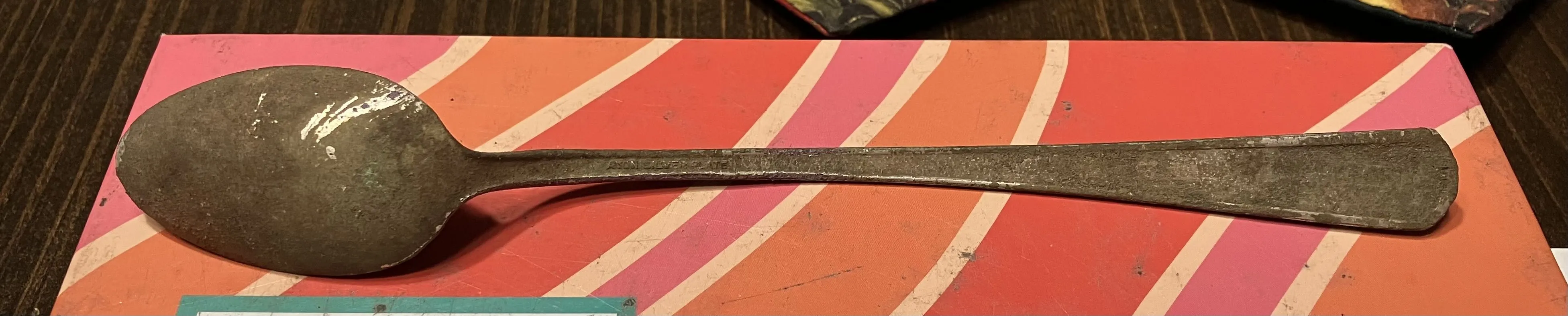

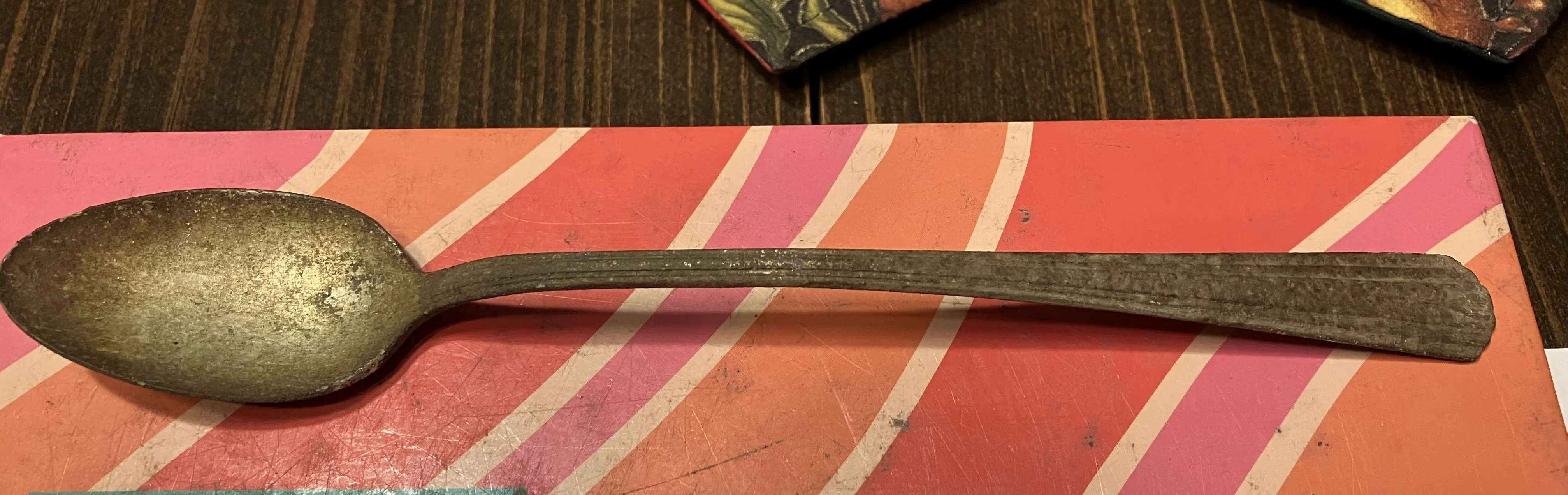

Mine says Avon Silver Plate on the handle spine. 7-7/8” long iced tea spoon. I’ll have to dig through storage to find the ones from years ago. Thanks. 👍🏼
That one is a 1940 pattern.
For the "tipped" fiddleback patterns originally posted, almost every major manufacturer had a version of those, and many of them are still made today.
Yes, evidently it was a go-to design, not overly ornate, yet a notch above spartan. A good utilitarian design with a little artistic flair.
