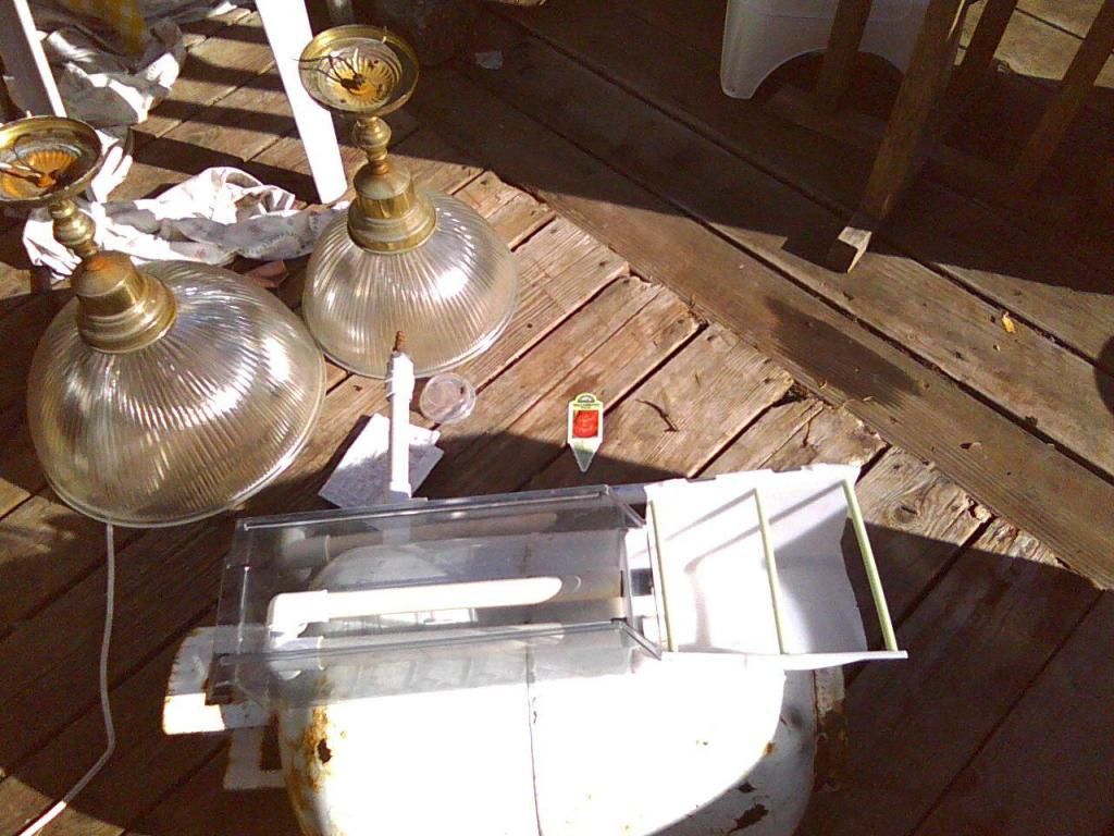

I use a plastic tub from a fridge about 7" deep and the ende part is a baby wipes box spread open by a plastic hanger. Thats what i use as the water collector.
1/2" pvc with 1/8's holes drilled. I have a top lid for it i use to classify. I gold all this stuff free the total cost was 0
