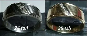

Here are two of the same style wedding rings I have found called channel rings.
Very common, I have found two others in the same style also with ice.
The bigger one by two sizes is the white gold one on the left, if the one on the right was much bigger it would have come in at the 40's and higher than those mid 30's you mentioned.
Both of these are also 10k.
