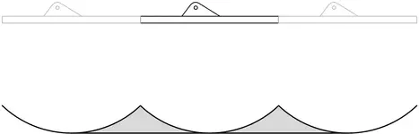

Let's say we sweep the coil with no overlap:
Assuming the curve is for a barely detectable coin, the gray area represents where the coin will be missed. If the coin is buried 8.5" deep (dashed line) then you've got about a 50-50 chance of hitting it.
