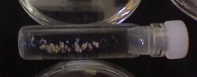

Here is a nice little bit of Platinum/Palladium flakes from the Medicine Bow Mountains
Before anyone jumps to say the M word....
Background.
1. I am a Jeweler by profession and know my metals.
2. Nitric Acid did not change it, neither did heat.
3. It took searching though over 6 troy ounces of Gold fines to come up with this tiny amount.
4. Placer Platinum has been reported int he past from this area

You also might think of hitting the Green above flamming gorge, I have found similar material below on the Utah side, The Garnet/rubies and Diamonds are interesting as well.

Forgive my amateur no nothing stupidity, but I see lotsa shapes, sizes, colors etc... in the vile how can I tell which flakes are the platinum ? I'm Missing something huh ? If it is all Platinum, how come so much of it looks different from each other ?
