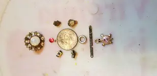

If you want to talk small targets, this is what I recovered at the beach with the Equinox 11" coil. Target wise, it is mostly junk (earring backs, pieces of small metal) except for the gold turtle charm, but I recovered them and recorded them around the dime to show just how small targets can bang on the Equinox. The registered in the high single digits to low teens.

Impressive even on the 11" coil, Thanks vferrari. I can pick those same items up with my Compadre...even some at but maybe not all at the beach. I have no doubt the Equinox can perform well in either case, hence why I may consider the 600 or 800 next year. But as a go to unit next to price I have no problem with the price/punch the Compadre offers on sensitivity along with it's lifetime warranty and it's blabsh. Please those who are trading everything in for just the Equinox...think again be sure to have around a trusty beep and dig analog unit.
