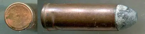

The early brass for the .45 Colt didn't have a head stamp, and the primer wasn't exposed. They were center fire but inside primed. Your head stamp dates the case,
but just off hand I don't remember when UMC was first used. These pictures show what the 1870's cartridges look like. The case was copper in those days.
1AA.webpNote, no visible primer, no head stamp. The crease on the cartridge case is to hold
the inside primed center fire primer in place.
