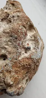

Oke, but i want to mention that the photo's i posted where not very good for indentification. Here is a new photo of my stone and a photo of a real lunar. My rock has voids that are filled with wat looks like calcium just like some lunars as seen on the second photo. And of course my stone is a weathered and old specimen but it has what looks like a thin brown cust.

Sorry, but the image of the lunar meteorite NWA 11273 doesn’t show what you think it shows. The matrix (as opposed to the thin fusion crust) of that meteorite and other lunars contains only tiny vesicles. NWA 11273 is a feldspathic breccia and the inclusions seen are clasts formed from repeated impacts on the lunar surface. The light-coloured clasts are anothositic rock and the dark clasts are basaltic.
Some lunars, particularly ancient specimens found in hot desert areas, do indeed have white and light-coloured calcite (not calcium) as a secondary alteration product from interaction with earth’s atmosphere and terrestrial fluids. However, in lunars, it’s not vesicular but arises in fractures and veins.
Your rock is not a meteorite.
