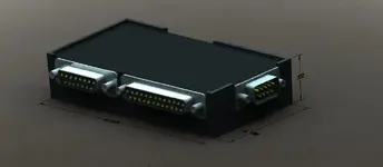

Thanks. but for this job, there is just so many ports on the outside of this box, that it's a lot quicker to just shoot some silicon. I thought of the tape meaure, but I knew it would take me a whole day to put the dams on the boxes.... here is a pic of the box I'm building... you can see how many things I need to block. I count 10 peices of tape... but if I just smear some silicon around on the inside, much faster.
OK, I see your point. Could there be anything you can add to the potting mix to thicken it? Even a homebrew additive?
