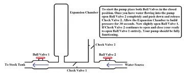

Something that I have noticed is nobody is explaining in the videos the direction these check valves need to be positioned. So here is a simple drawing I made up that shows the direction the valves need to be in.
Htdraulic Ram Pump Drawing.webp​

Yeah it is cool stuff. I can see where the Hydraulic Ram Pump has many uses. Even for someone who has a stock tank on their property that's feed from a underground well. If there is a slope downhill from the stock tank and the user needs water in another location where gravity of the water from the stock tank can not put the water up and over a hill the Hydraulic Ram pump will work provided the head pressure is enough for the pump to work to the height needed to put water into the other location. It's a 1 to 7 ratio for the pump they designed. So 5 ft. of head will result in the pump having 35ft of lift. This pump would be great to have water from a stream delivering water to your camp.
For anyone wanting to build this pump I suggest that you read this article (How To Build A Hydraulic Ram Pump) Instead of using expensive brass check valves and steel fittings you can cut your cost and build the entire pump from PVC including using PVC check valves such as the valve pictured.

Sounds complicated and not very user friendly. The Hydraulic Ram pump is very easy to build, easy to maintain, easy to start, and will deliver the needed water. What more do you want from a simple design that was developed 218 years ago and still in use in commercial operations today. There are a number of companies that build a more advance Hydraulic Ram pumps, but those who want hassle free (FREE WATER) from a stream this HRP does what its intended to do.

This was the part in your description that indicated it was not user friendly. (injects steam at around 60 psi) You left the readers with the idea of using steam. Show the readers with a drawing how the system works or is this a business opportunity?
