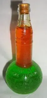

Yes, Deco basically means Decorative Arts. Which basically had it's birth in 1925 at the World's Fair in Paris. That whole decorative arts movement transended around the world. The most notable American example is the Chrysler building in New York, built in 1928.
Does the bottle have collectability even with it being chipped?
Even in mint condition that particular bottle would not offer much in the way of collectibility or value. It's sort of plain jane. But other deco bottles, especially the more elobrate ones, are highly sought after. There are dozens if not hundreds of different deco bottles. Check e-bay and you will see what I mean.
The deco bottle shown below is one of the best of the best. It came out in 1927 by the "Nehi" company. It is called "The Top of the World" bottle. If you ever see one of these, grab it! I still don't have one myself, but hope to some day.
