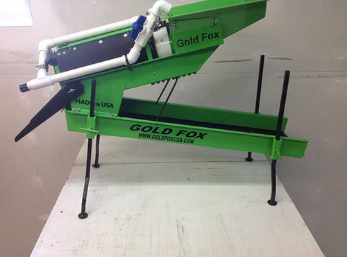

I like angle screens, but the dirt is so compact here that without at least shaking it or running a gloved hand over it, I lose too much. If you want a hand operated machine, you could also try a small trommel.
I run my little Gold Fox all the time.
But if you just want to classify in the bush, then this little home made one is something to think about -
