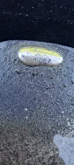

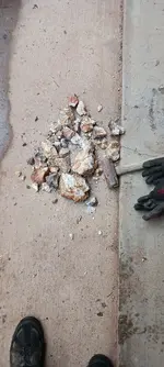

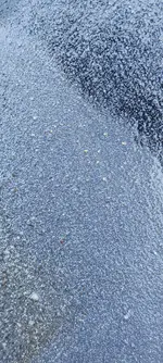

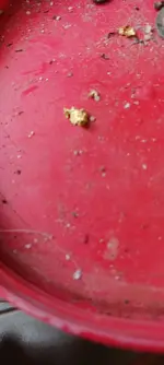

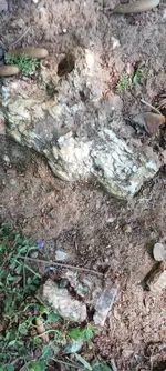

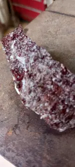

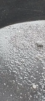

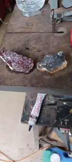

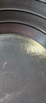

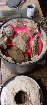

Raining today a good day to roast rocks ten minutes in the furnace and their ready to crush. It makes it easy to breakup into smaller pieces to feed the jaw crusher then a trip through the chain mill. I have found with our ores two trips through the chain mill increases our recovery of gold. Just pieces of float uncovered while raking and burning I just toss next to a tree to pick up latter. Some of large chunks gets tossed into the burn pile for a pre roast then single jacked into pieces that will fit into the small furnace. The black rock is a before the roast and reddish after, then dolly pot and a small line of micro gold to the left of the reflection. I have a bucket full to crush maybe I'll have some good luck Happy Mining

Are you getting gold from this? View attachment 2204669
Yes, that's the piece I crushed in the dolly pot second picture of micro gold. Most of the rock with the red oxidized / weathered look contain gold some more than others. The grainy black veins are sometimes loaded with free gold also this stuff won't set the detectors off. Unless there's a good pinch in the pockets.

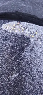

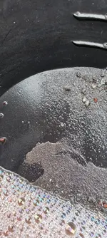

I finished roasting the bucket one piece maybe Diorite caught my eye. The bottom piece in the furnace I gave it a whack looked blackish inside and hard as hell. I crushed and panned a small piece and found a speck or two. Now I have a bucket full of mostly quartz rocks to crush maybe tomorrow if the sun is out. The gold is near the top middle a speck with some micro dust.
