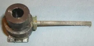

I found today many expended sights, overdraws, scopes, broad heads and various equipment. Some of the scopes are 2X, 3X, 5X power. I have 3 "Power scopes" and I forget the power rating. But the one I used in competition had a "special" lens mounted into a special peep sight casing and put into the string. Then upon full draw I'd look through this lens into another scope on an extended sight. You wouldn't believe how little I could see. But if you had the strength and stamina within a few seconds to draw, anchor, stabilize, aim and execute the release you could see a fly's a$$ only.
If anybody has any info or questions I'll try and help
