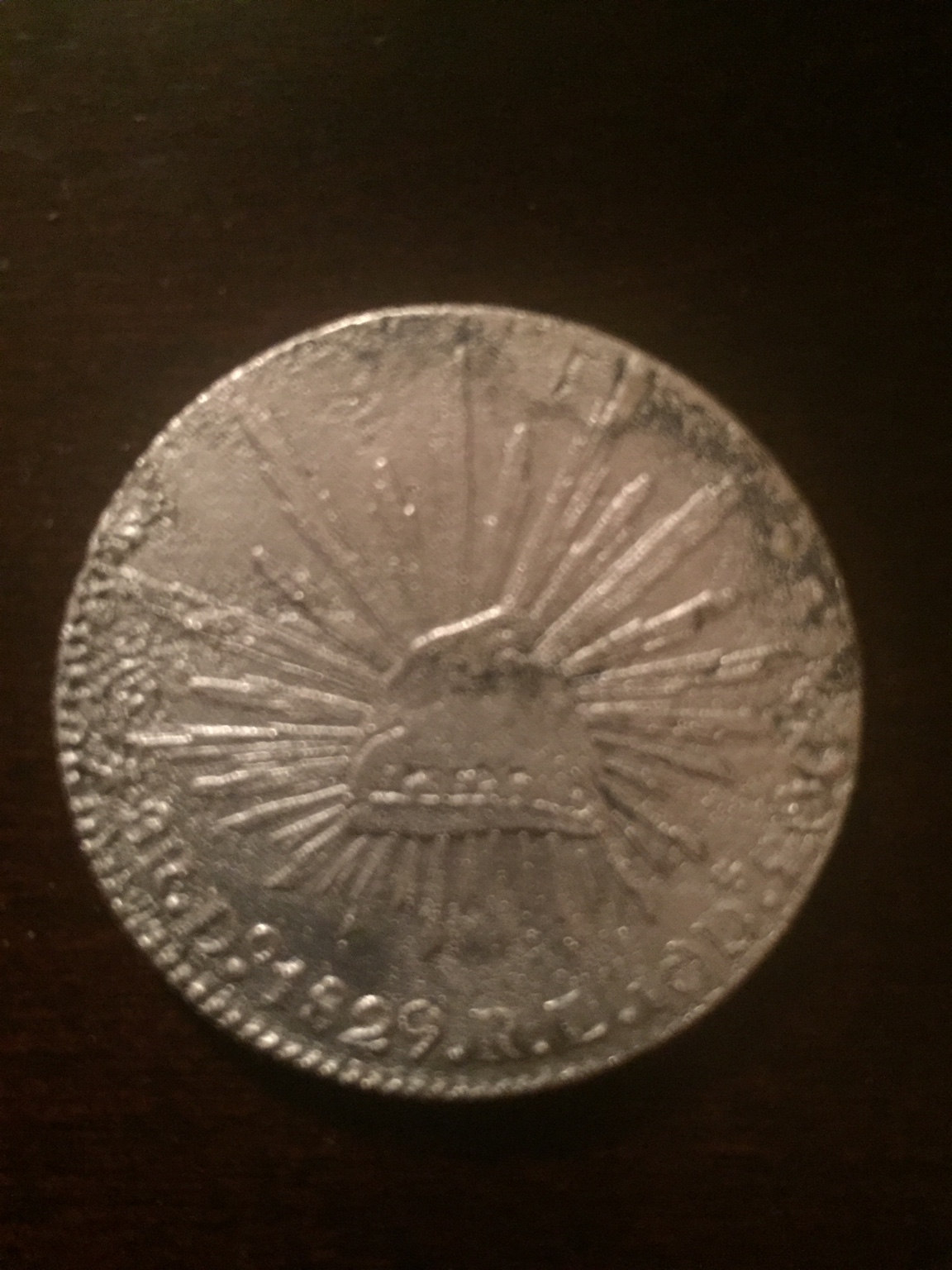

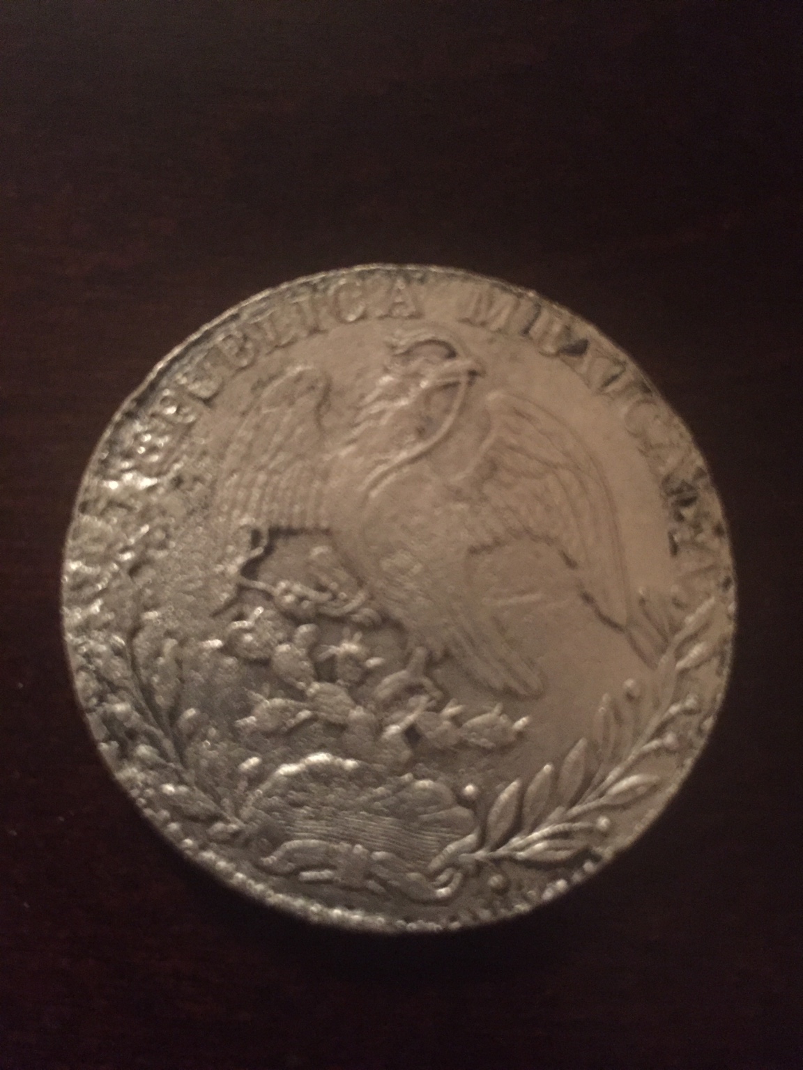

Going good. I went to old Covington two weeks ago and look what I found about 7 inches deep between a sidewalk and the street. I [emoji90] you not.
Sent from my iPhone using Tapatalk
