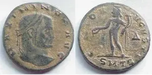

Coin 2 is certainly a MAXIMINUS II probably Thessalonica mint Greece as follows:
Maximinus II AE Follis. AD 312. MAXIMINVS PF AVG, laureate head right / IOVI CONSERVATORI, Jupiter standing left, holding globe & leaning on sceptre, wreath in left field, A in right field, dot SM dot TS dot in ex. RIC Vol VI page 518 No 50a

could find the same maximus with the delta but found almost the same _thessalonica_RIC_042.webp
