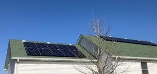

Hi Everyone,
Our rooftop solar system went fully operational this past Wednesday. YAY!!!
We got twenty-eight 370W panels and a Tesla Powerwall 2 battery. Our home is fully electric and we have well water. Here's a photo of 18 of the 28 panels:
