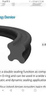

So for anyone interested, the orings used by tesoro for the sand shark turned out to not be just regular off the shelf orings. They used what is called a quad ring or x ring. I just ordered 100 if anyone needs some.

Roger that Smokey, as was I. I was however in the process of replacing them when I noticed that they were not regular orings. I will attach an image of what mine looked like. How long have yours held up? Regardles I got some from mcmaster carr.
