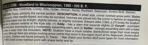

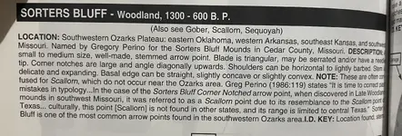

Found a point today that I thought would be easy to I?d in my overstreet book but I?m not finding that corner notch with the round base combo, I looked on projectilepoints.net and it says scallorn, I was under the impression that scallorn was now limited to Texas and they went by sorters bluff around here. Now I?m wondering what the truth is because it?s seems both sources are fairly reliable. As for the point just like many others I find it isn?t going to fit neatly into any types I can find all the sorters bluff seem to have a flatter base that is the same width as the barbs
That’s what I’m saying, not sure who to believe , to my knowledge this is the newest edition.. #15

Scallorns were identified at the Big Eddy site in Southwest Missouri, so parts of Kansas seem pretty reasonable from a distance point of view.

With all the damage at the base, I'm not sure one can say with certainty that it had a round base. Both types you mention occur in the same timeframe; i.e. Late Woodland into Mississippian.

I agree sorters bluff and scallorn are probably contemporaries, likely related. I’m not sure why some have decided to limit scallorn to Texas but I’m guess they have good reason for it to be published. Sounds like either overstreet is getting ahead of themselves on something not yet settled or projectilepoints hasn’t updated with the latest info on scallorn points. I just like to be as correct as I can be when labeling things In my collection, I try not to spread misinformation.
