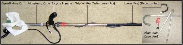

Scrooge, Here's The Home Made Straight Shaft.......
Thanks for the reminder. You can pick up those aluminum canes from a thrift shop cheap. The arm cuff I got from a local dealer in the junk bin.

Re: Scrooge, Here's The Home Made Straight Shaft.......
nice job. How does the Infinium rod attach to the cane???
I don't use the straight rod on the Infinium. I probably could....I would have to drill a couple of holes near the elbow cuff and attach that apparatus there.
