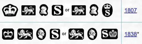

I just went to my local ARC after some all day yard work. In the show case I see these 2 new additions. Sure looked like good stuff to me. Ran down an employee and said could you be so kind to unlock the show case and they did. I could see the little pitcher had a brit hallmark, close to the top rim, but it was very worn down. Getting home I see it's N*S & Co. With a paw raised Lion and a Date mark I've not seen before. It's a Crown with a letter S below in a oval shape border. I did I.D. the maker as Nathaniel Smith & Co of Sheffield. The only date mark on a listing I see with the crown and S would put this at being made in the year 1838. The gravy boat looks to have a very worn possibly French mark, so it'll be more difficult to date, but it does look rather old. My local PM buyer now has one of those very expensive spetro guns and can read with utmost accuracy all the alloy % with in a few microns of the surface. It's pretty slick and they now can buy at exactly what alloys you bring them. This gravy boat I'm speculating will be at least 80% alloy silver. Both pieces are in pretty rough shape. The pitcher is 112 grams and the GB is 231 grams. All total I gave just under $31.00.

The ‘pitcher’ is what we call a milk jug, sometimes improperly referred to as a ‘creamer’, since it was for the milk to go in your cup of tea. Yes. It’s from Nathaniel Smith & Co but it’s not from 1838 since they weren’t still in business then. It’s not clear when they ceased trading but most sources say c.1808
The crowned letter is a legitimate part of the Sheffield sterling hallmark set but when you read our hallmarks everything matters. Cartouche shapes, font styles, placement of symbols etc. The date is 1807 and you can see the difference from an 1838 mark below (and note also the difference between the Kings' heads for duty marking):

Thank you Red-Coat. 1807 then. Boy that be a fair amount of sugar if this vessel was filled with it. I'll post the findings of when I have it tested for its particular alloy content. If it's anything other than sterling that might give me an idea as to where it's possible from. Yeah it's a bit sad there are no clear identifying marks as that does make a piece of silver a bit more interesting.
