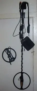

Personally 1 would get a new one then there is no worry's its a great machine , i use mine mainly for fields and wooded areas i do like beaches though in wet sand its great , i use the Tornado stock 10" coil and the Intruder S-12 coil ounce for ounce the 12" is a little lighter then the 10" coil i was surprised , get a hip mount bag ! i keep my bag at chest height i can swing that rod all day there is really no weight with the hip bag , i did mount a Sun Ray S-1 search probe 18 inches higher then where it normally belongs above the hand grip only because i am 6-5 inches tall and to get a full swing while using the hip bag i had to at chest height ,still the search probe has really not much weight to it . All in all the Sov GT is one of the best machines out there Minelab wins hands down :icon_thumleft: for service and depth . I included a few pictures of my machine set up to my liking not pictured i use the Black Widow headphones and Joe Patrick,s Insight 180 ID meter built in the control box . Jim HH :thumbsup:
