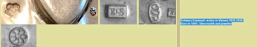

It looks like it is an .800 silver Austrian Athena mark dating from 1867-1922. Possibly Schwarz Emanuel: active in Vienna 1876-1910
Born in 1841. Silversmith and jeweler

Thanks all for the tips on using 18K acid to test for silver. I will start experimenting with that method. Fortunately, I was able to decipher the marks on this one and ended up with 907 grams of antique, Austrian .800 silver.
