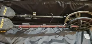

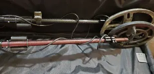

Bayoutalker --

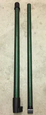

OK, here are some pics, as I promised. The first one will show my middle shaft (a green-black one), next to a Garrett middle shaft. This will help you to see that the connection point to the upper Garrett shaft section is the same, on both. (Note that my middle shaft DOES NOT have spring button/pin holes -- that is BY DESIGN, as they are not needed due to the heavy-duty clamp-type cam lock I am using to connect the lower and middle shaft sections; this makes lower rod length adjustment much quicker and easier, and also UNLIMITED, in terms of adjustment length, as opposed to when being confined to using the fixed button hole locations, as on the stock shaft.)
Next, I'll show that connection point, where the middle shaft connects to the upper, with my shaft installed on the Garrett upper...

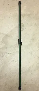

Now, I'll show a picture of the clamping cam lock, employed to connect the middle and lower shaft sections.
Here is a picture of the four middle shafts, each in one of the four colors that I chose, to build this first batch of prototype shafts (left to right, the colors are black, green/black, blue/black, and red/black...)

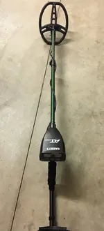

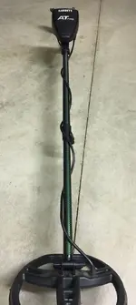

Finally, here are some pictures of the shaft fully assembled and attached to the AT Pro upper -- ready to hunt!
