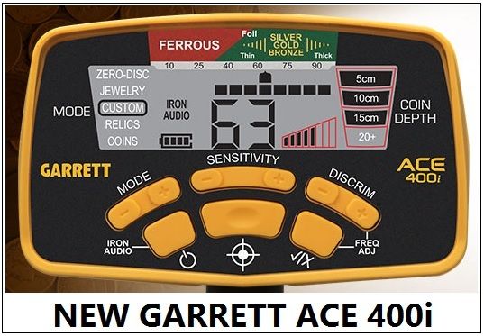

Well, fast forward it to 2016, and a new Garrett ACE Series has been released. The Top of the ACE line, the "Ace 400i" has even more improvements over it's earlier production models. The new ACE 400i now has cam-locks, a request many have made to Garrett and they listened. The front of the screen now has a large digital target ID, using numbers plus target probability numbers suggesting ferrous/non ferrous conductivity. Also new is the "iron Audio" feature, available only on higher, more expensive metal detectors. This helps eliminate junk targets by designating them with a distinguishable low tone in the iron range, which might be junk, depending on what type of targets you are searching for. To help eliminate EMI (electro-magnetic-interference) Garrett has given you the option of hunting with different frequencies. This will also allow you to hunt close to your buddy by elimination his metal detector interference. And....the coils off the older ACE's work fine on the new ACE Models. So hang on to your sniper coils!

Garrett still has maintained the notching system, which is also available in the higher end AT Pro/AT Gold Series. This allows you to selectively remove junk targets so you won't hear the audio, or set it up to just hear one particular target. This comes in handy when searching for a lost earring. You can remove all notches except the one(s) sounding off on the remaining earring, then search with ease for the other earring. And......you do NOT lose more depth removing notches for unwanted targets like on other metal detectors with knobs to add discrimination, where as you advance the knob to remove further targets, where you do in fact lose depth.
To those considering the New ACE 200, 300 or 400, it is simple to use. It's well balanced and only weighs 2.9 lbs. (1.32 kg.). The length of the rod can be adjusted, depending on a persons height. It comes pre-programmed for your choices of coin mode, relic mode, jewelry mode, a custom mode (you create it, it saves it) or a setting with no discrimination so you can hear all targets. It is so simple to operate or sequence through the different programs. It operates on 4 x "AA" Batteries and readily excepts rechargeable batteries. I managed about 27 hours on the set of batteries which came with the metal detector.

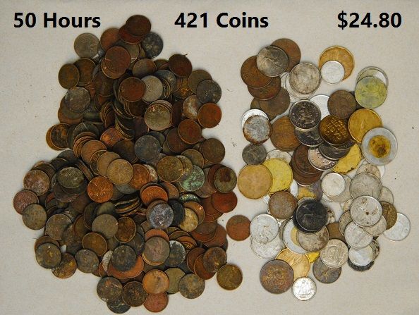

Here are the results of my 10 hunts. This machine is a Super coin magnet! I started hunting in relics mode, hunting a lot of schools and sports fields. As I learned where my (Canadian) coins were reading with the VDI, I began to remove some notches. I pretty well ended up using the coins mode, as it also maintains notches where most (but not all) gold rings will read. I used my old concentric 9" x 12" coil from my old ACE 250 mostly. Bottles caps often read as good copper/silver coins, so using the iron audio can help to eliminated them. I discovered that deeper bottle caps read higher compared to more shallow ones. So......bottle caps and aluminum pull tabs remain the "Curse" for metal detector users. The square pull tabs often tend to give a strong double beep, whereas nickels have a softer single beep sound. It got so I could guess a nickel would pop up with a good probability. Hey....these things happen when the hours accumulate on a detector. One thing for sure....the ace BANGS hard on coins. Because the weak signals on the ACE are amplified so you can easily hear them, (unlike the modulated volume on the AT Series) hunting without headphones becomes easy in a quiet environment. Wireless headsets not required!

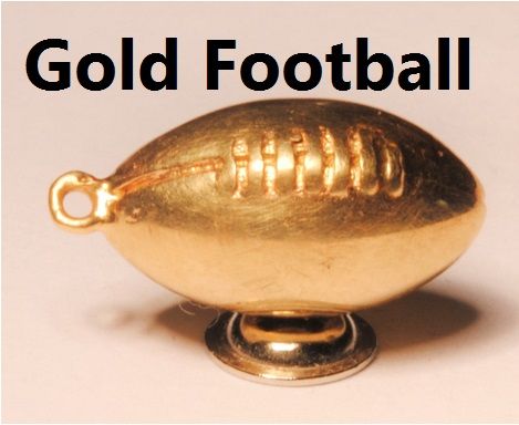

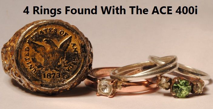

I did manage to dig up 4 rings during my hunts. You can't miss them. They hit hard! The older ACE models were very good for hitting rings, including gold ones. I didn't find any gold rings, however, I did get a solid gold football charm in a sports field! That was a first!

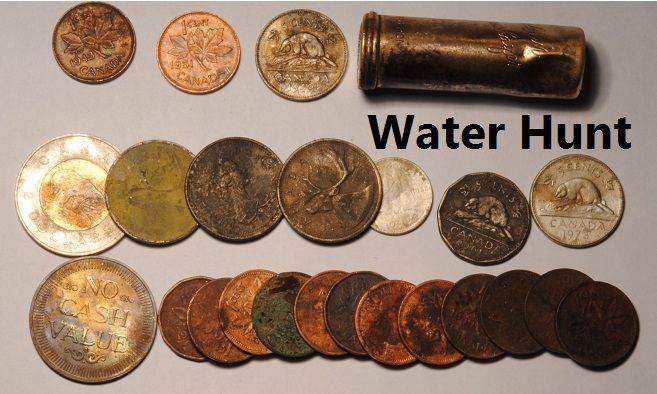

My last 3 hours metal detecting were done in a freshwater lake. Because only the coil is water proof, I hunted just the beginnings of the freshwater lake. I notched out nearly everything except where gold rings might show up. That left only 4, sometimes 5 notches left on the screen. I had built up my confidence with this machine that any old silver coins/rings or older copper coins would easily be hit on. I got pennies in the 40's on up, but no rings today.
