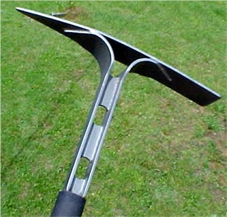

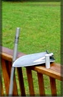

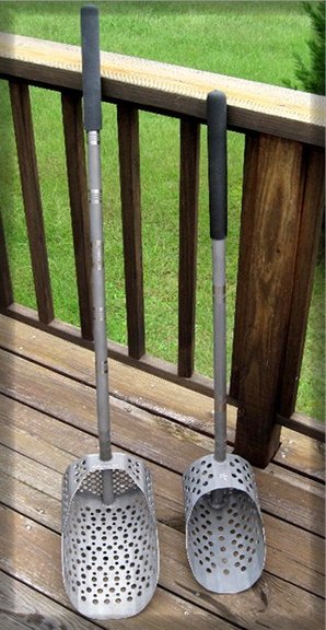

Just wanted to share with you some tools I fabricated using Titanium. I've been using the diggers and scoop for a few years now and they are the lightest and strongest tools I have ever used. Virtually indestructable! If I can figure out how to produce these a little faster, I may offer some for sale in the future.
Thanks for looking.

wtg those are beautiful , I really like your diggers , to me I think this is one of the greatest asspects of this hobby is that folks build stuff , or take an idea an run with it to make it bigger better stronger .
great builds :icon_thumleft:

Please add me to your mailing list. I might be one of the first in line to buy some. Just out of curiosity, how does the material cost compare to say aluminum or steel?

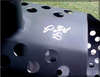

Great looken tools!!! How did you get the holes in the scoop?

Thanks to all for the kind compliments. To answer a few of your questions, Yes Titanium is VERY strong. A sand scoop or digger made from this stuff will last several lifetimes. The downside, and it is a big downside, is cost. The sandscoop alone has about 150.00 in material (if I had to purchase it). I have an idea to put a long handle on it, of a removable design. But a five foot tube cost about 160.00 for the size I need. So I may have to go with aluminum for that. The other factor is fabrication. Jeffro, you are right. Titanium is hard to fab. You need a mill to machine the stuff and you need to go SLOOO. It can be welded fairly easy using TIG with shielding gas behind the weld to prevent oxidation. I use slivers of Titanium for filler rod.

This scoop would be hard to mangle! Maybe if you run it over with a truck or something...The scoop in the picture is about 5 yrs. old.. Still new!!
I will let you know when I make another and let you all know cost. Hopfully I can keep it down to make it somewhat affordable..??

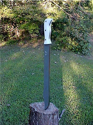

I have used a number of titanium tools for field work. I have purchased at least one of everything that Mission Knife and Tool makes, and a lot of some of the items. For metal detecting I have found that their take apart mine probe and the military demining knife are great. My team has used them all over the world, we are geologists and geophysicists and use them to aid in soil sampling. The soil samples are measured in my lab to assist in predicting instrumentation response in other countries.
I don't work for Mission, but I have been very pleased with their customer service, pricing and quality. The MPT12-Ti Titanium Knife is an awesome knife, it's just really big.

A few tools made from Grade 5 and Grade 9 titanium...
Best to ya!
-Wayne
Very nice tools. I really like the hand pick! I use grade 2 titanium.

The pick was made from grade 5(6-4). I made it several years ago when the fab shop I was working at had a 220 ton press break. You'll notice the handle was made using two curved pieces... I broke one of them trying to bend it to the right angle! So I had to make another one and hope for the best!
How did you put the holes in your scoop?
All I have is a cheap Craftsman drill press. It took a long time to put the holes in my scoops!

Yep the holes are a B---h to drill. I used a bridgeport mill to do mine, but I did start small and work up to the size I wanted with the material clamped down. Then used a sheet metal roller to bend it round.
